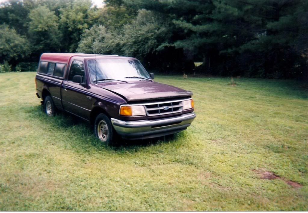

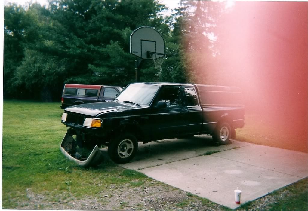

This is my 94 Ranger that I've had since 2003.
My family got it for free when my cousins grandpa moved to South Carolina and didnt think it was capable of making the trip down there. He told us it ran like crap and he didnt want to screw with it, so if we wanted it we could have it. I had the honors of driving it home from the back yard it was parked in and yeah, it ran like crap. I got it home and popped the hood only to find the air intake tube was disconnected at the intake manifold and half of the spark plug wires had been disconnected from the spark plugs. After discovering those things and fixing them, my dad and I decided to give the truck a full once over and also discovered the rear leaf spring hangers and front coil spring buckets were rusting out so we replaced them before putting the truck into service. My family members including myself, drove the truck on and off for the next four years until it started having cooling/heating issues and then we decided it would be an emergency backup vehicle.

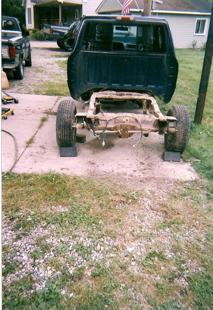

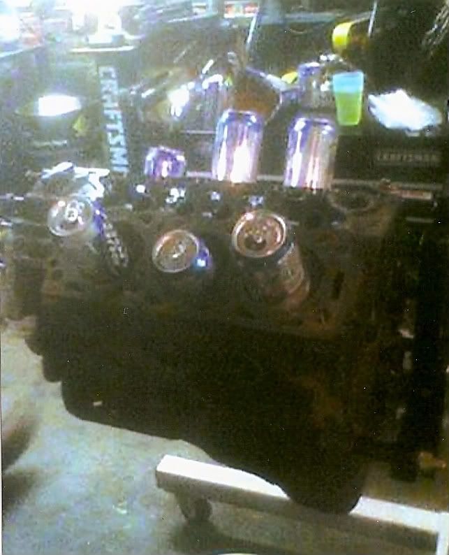

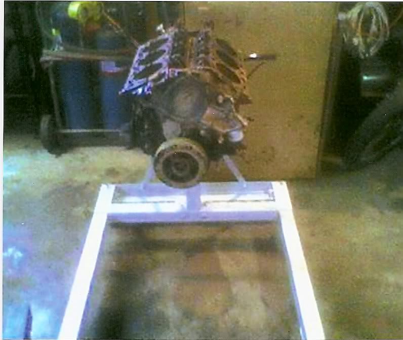

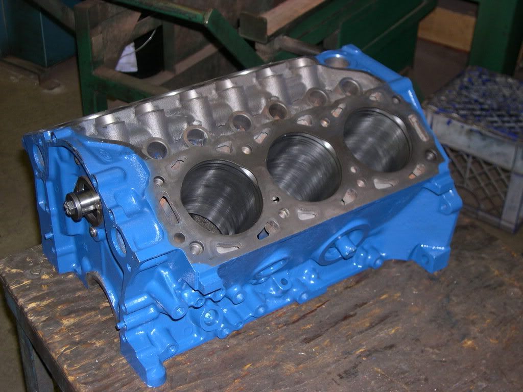

When i came home with the heads and a price sheet for my brother, there were about three full size pickup trucks in the drive way with what looked like my brothers bed and dresser and tv stand in them. Come to find out my brother and the next door neighbor who have been friends since they were six decided to move into an apartment that was two blocks down the street from the restaurant they both were working at. Since he now didnt need a car to get to work, I was left with a broken truck in the gargae spread out in a hundred pieces and no money to put it back together with. Frustrated with my brothers inconsideration toward my time and energy put into the truck, I threw all the parts into the bed and put the topper back on it and pushed it back outside. For five months it sat outside with nothing but a towel over its bare block until i finally decided to turn it into my project in March of 2008. My plans were to pull the motor out and rebuild it completely (since it had been outside for five months it was really my only option), swap out the A4LD for an M5OD since I had already done the swap before on my 90' and never regreted it, and replace any other worn out parts i found along the way (as youll soon see i may have gone a little overboard?).

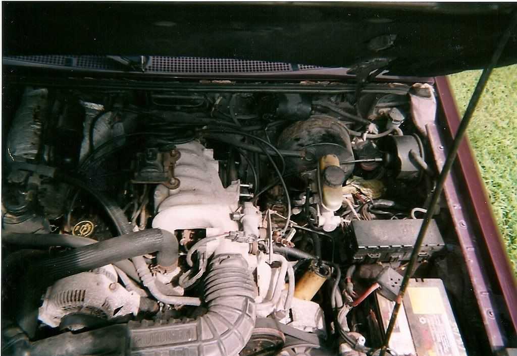

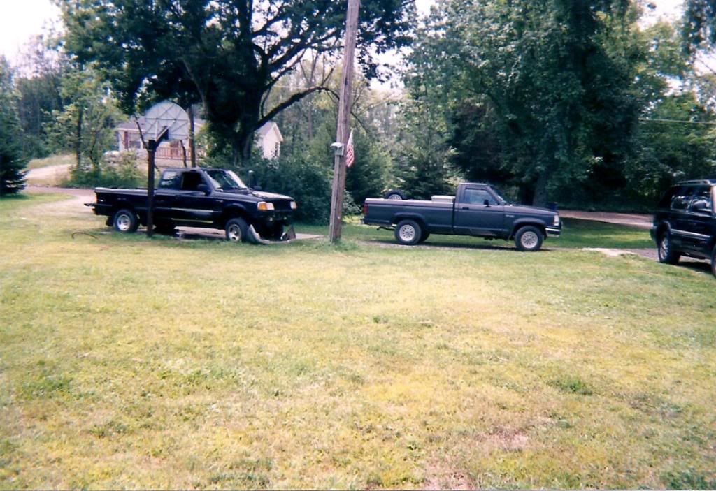

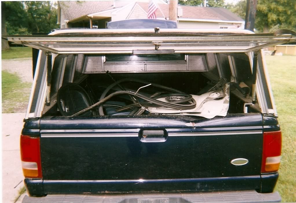

I picked up this 94' ranger as a parts truck, which also had the 3.0l in it for $300. It had 200,000 +miles on it, but it had all the parts I needed for the MT swap and the motor was unmolested and would make a perfect diagram for me to look at when putting my project truck back together. I got the red topper from my friends dad whos 85 ranger had recently blown up and put it into use as a storage facility.

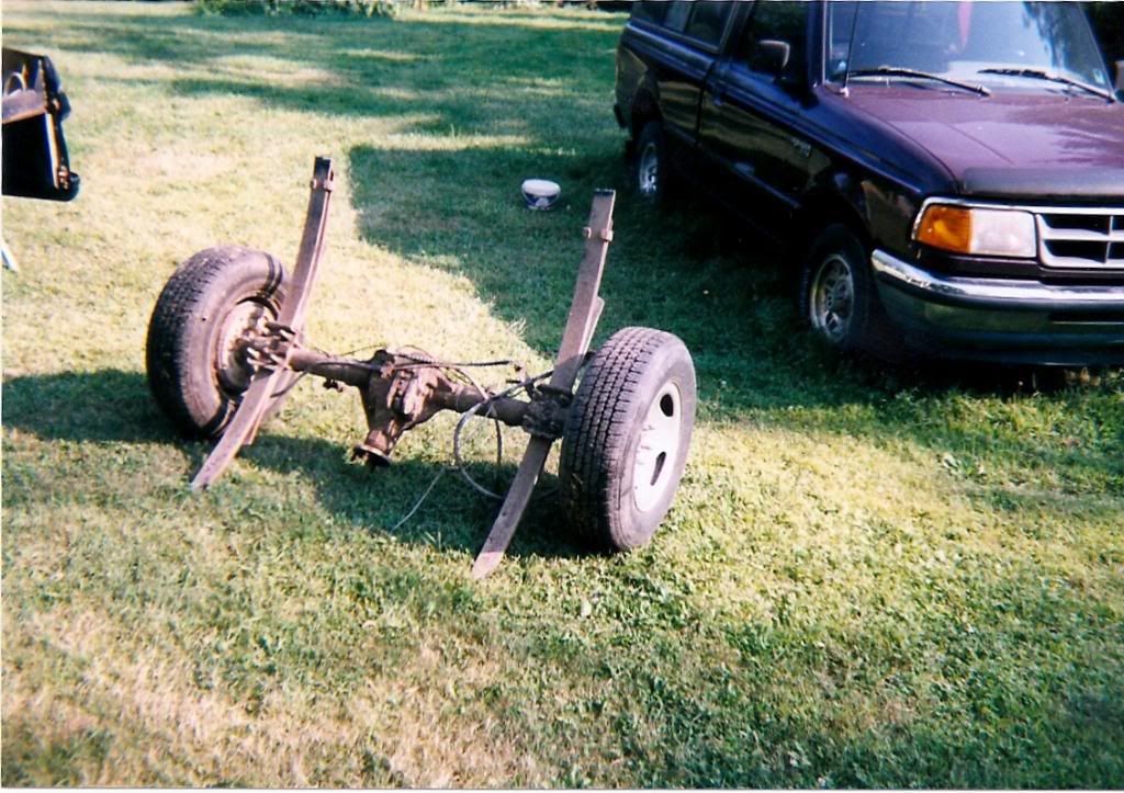

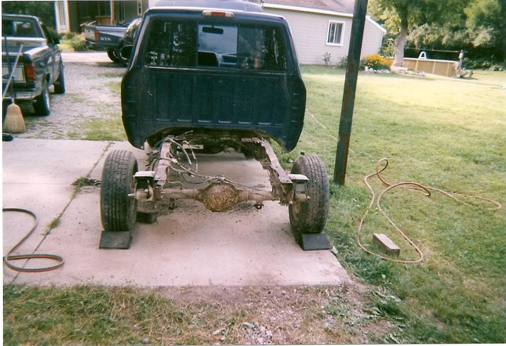

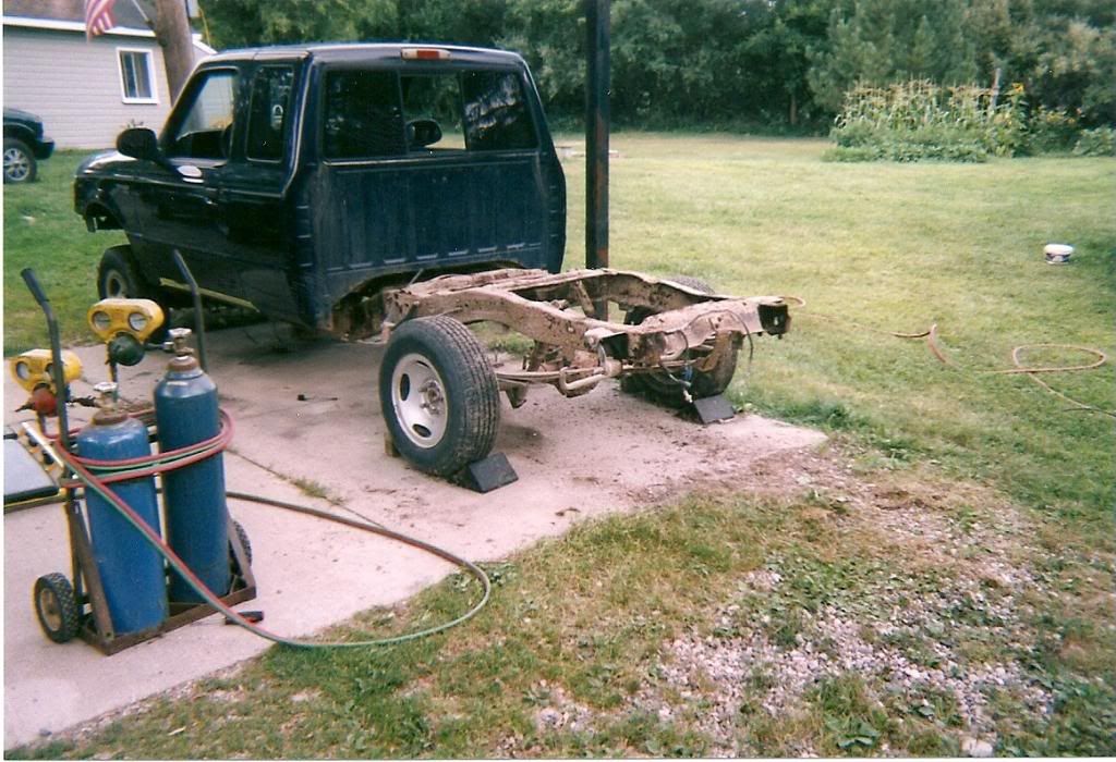

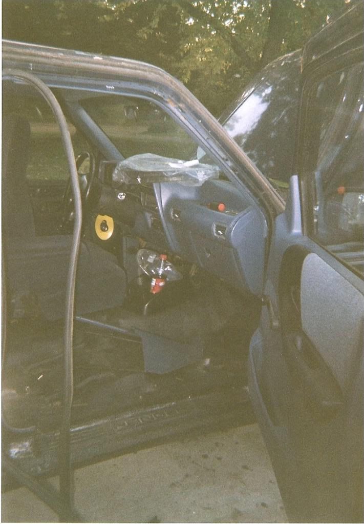

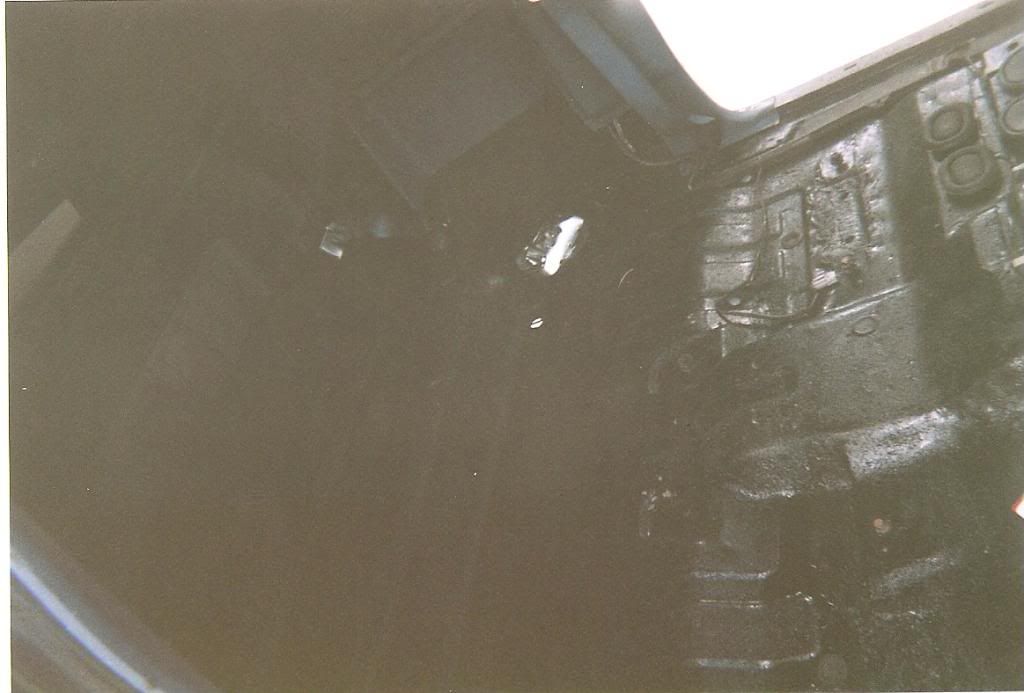

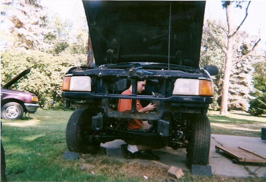

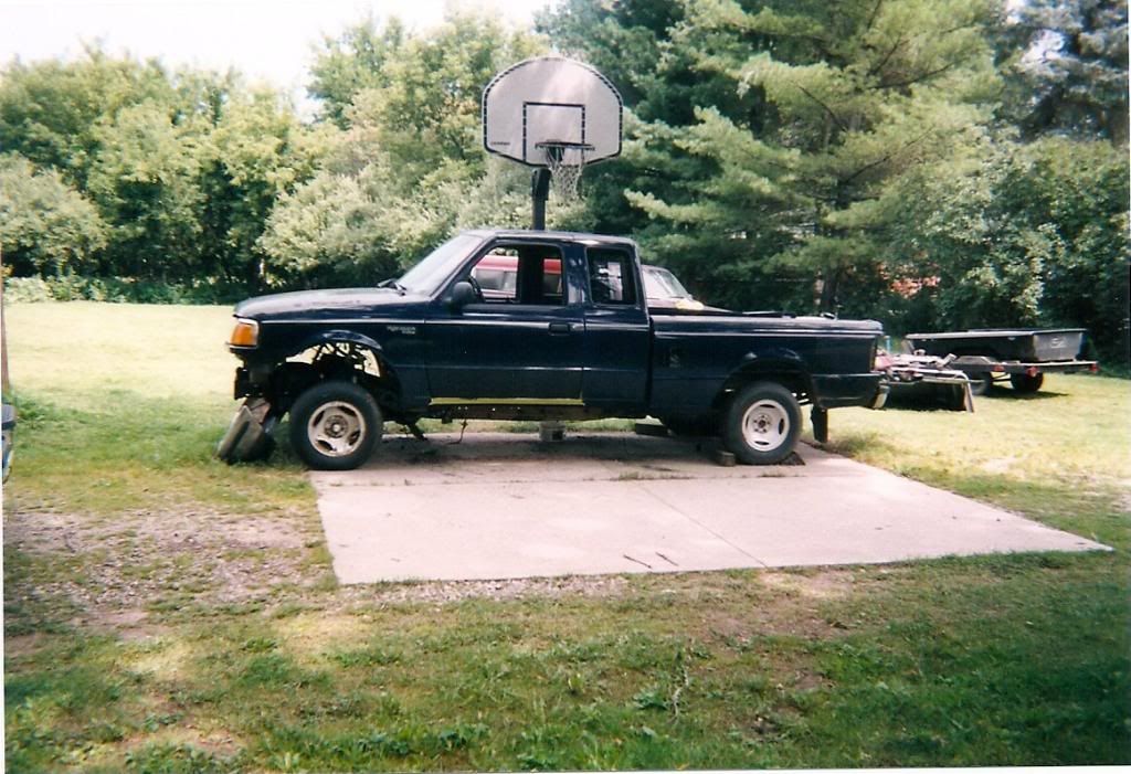

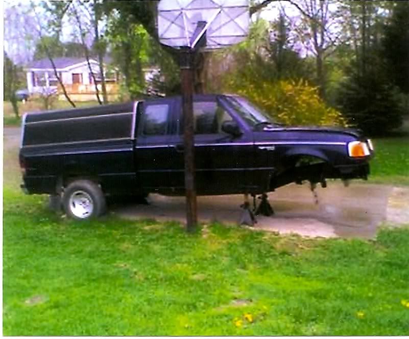

In the beginning of this build I didnt take many pictures because I didnt think it was necessary, but as the build went on I decided that just replacing worn out parts wasnt going to satisfy my urge to modify and soon realized this was going to turn into a big project. Here are the pictures from the first month of rebuilding:

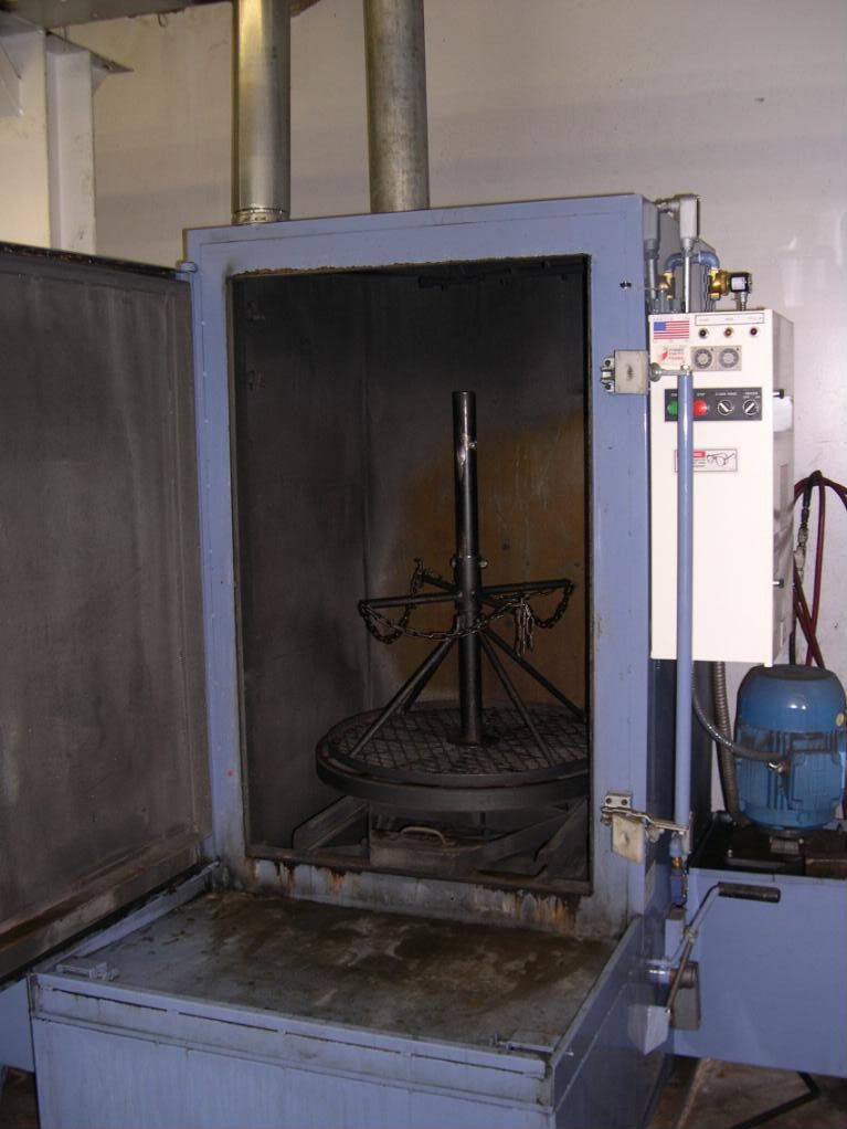

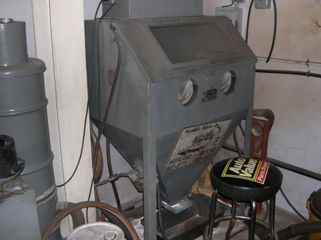

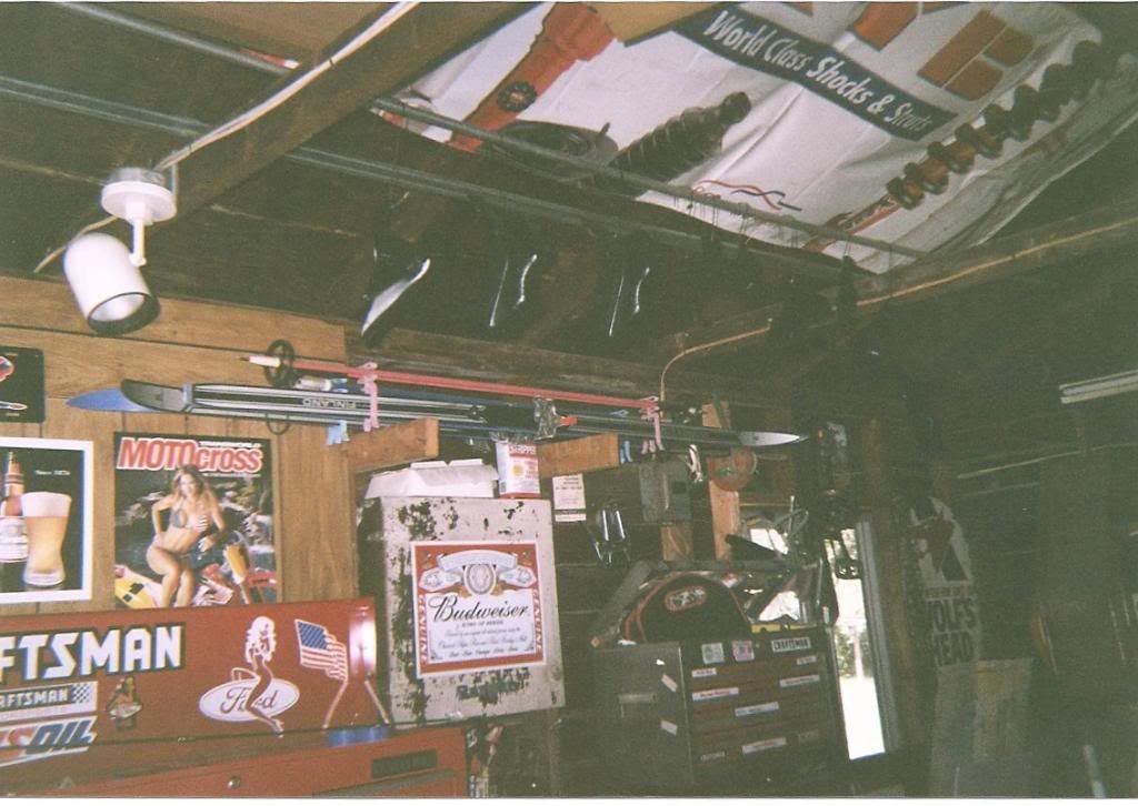

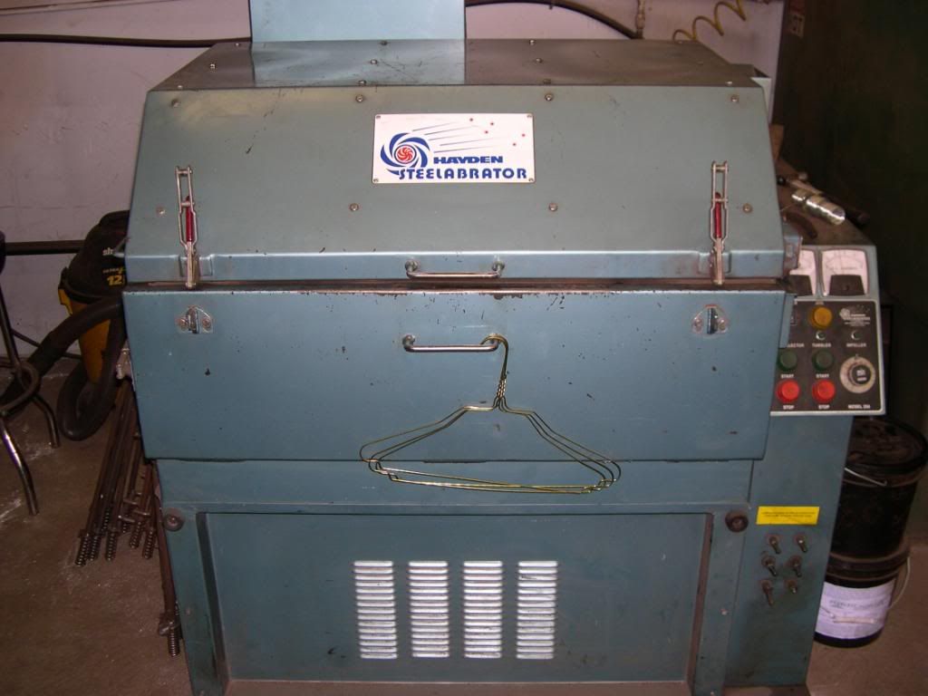

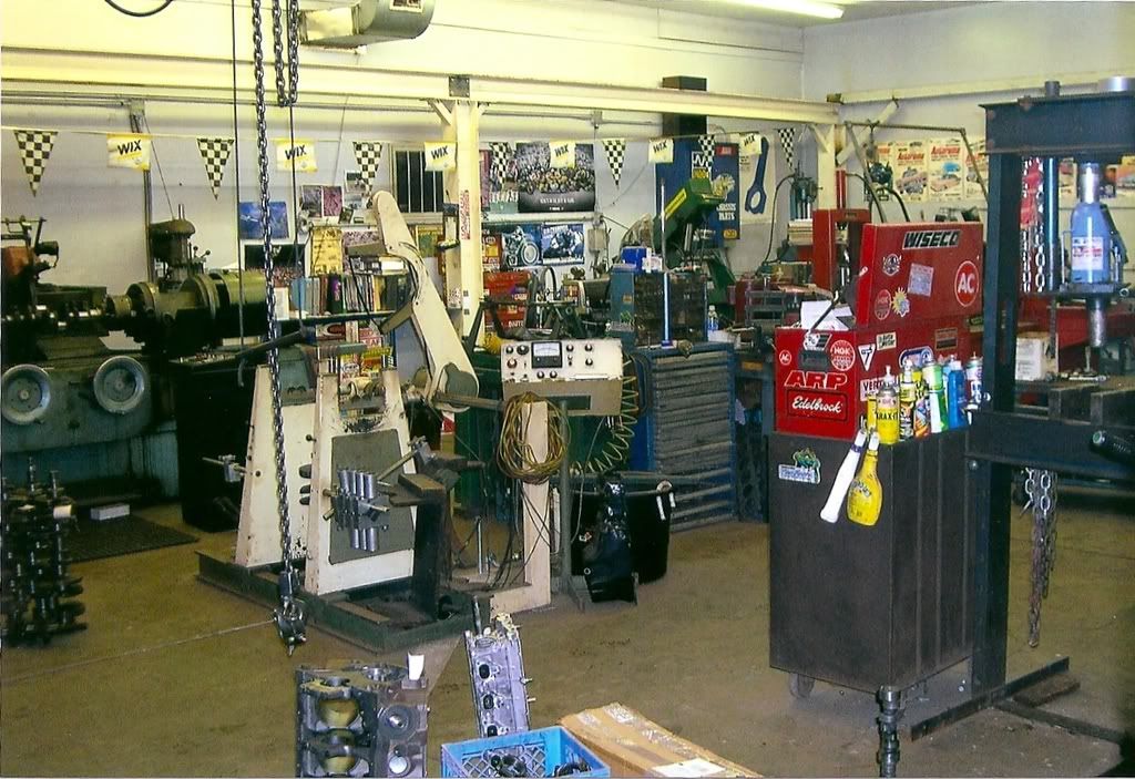

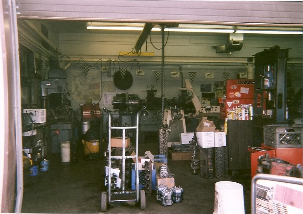

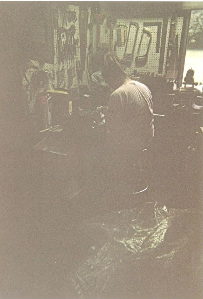

These are some pictures of our machine shop where the motor work took place:
Crank grinding machine
Cylinder honing machine
Cylinder boring machine
Block decking machine
Sand blasting cabinet (which ive spent many hours staring into)
Steel shot blaster
Oven for cooking blocks and heads and lots of rusty parts before they go into the shot blaster.
Spray off tank (think giant dishwasher with aluminum cleaner in it)
Piston wrist pin remover/installer
20 OTC ton press

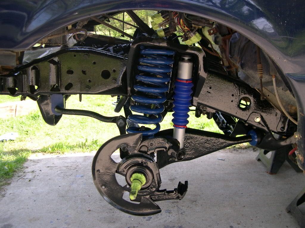

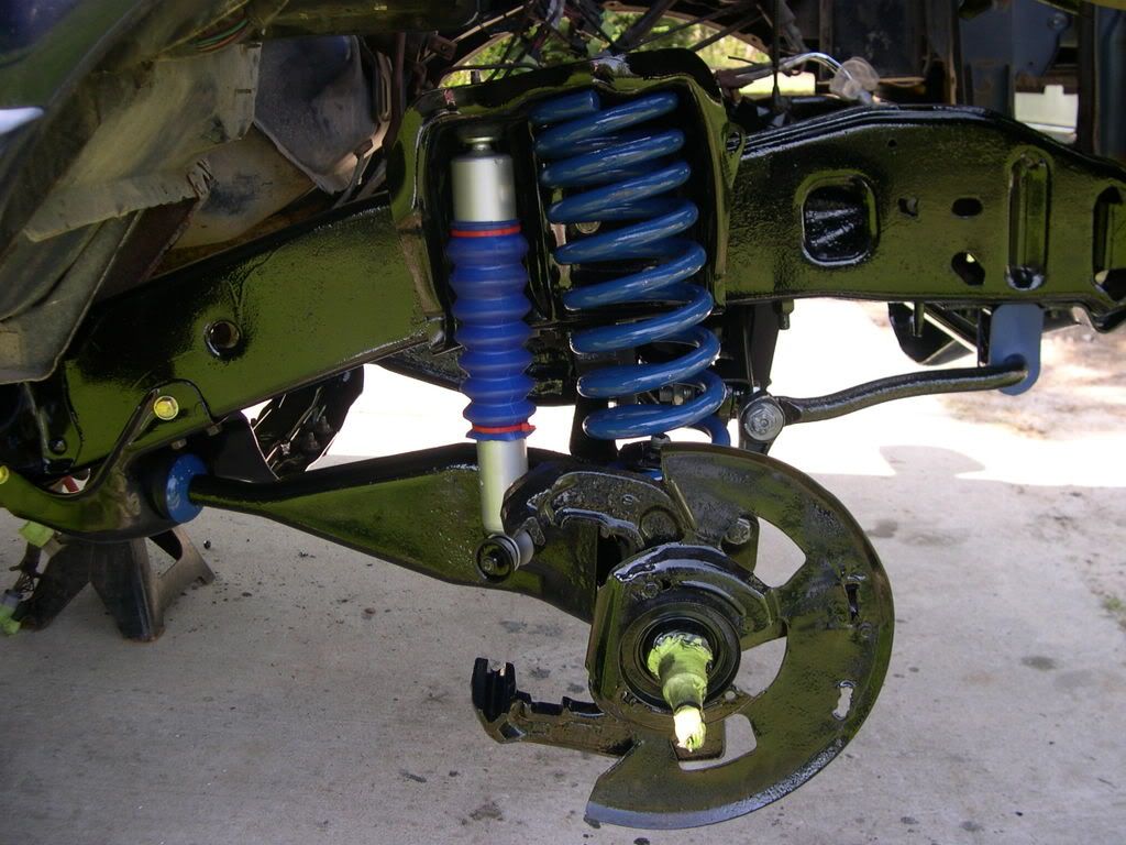

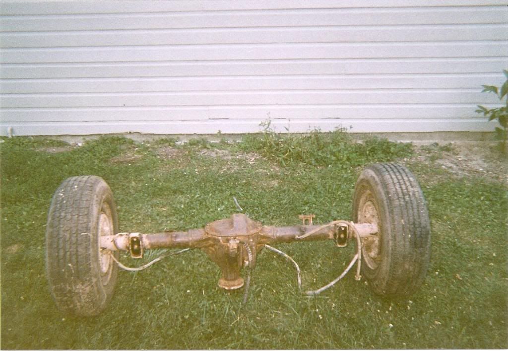

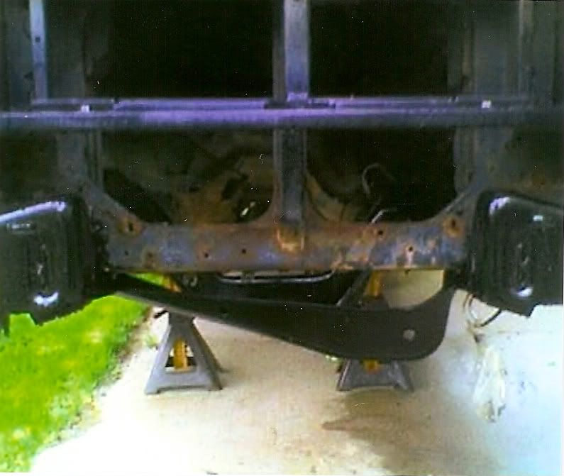

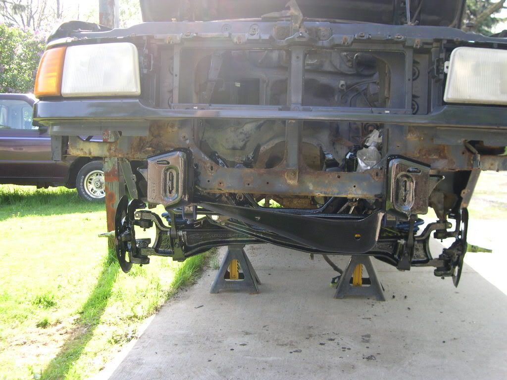

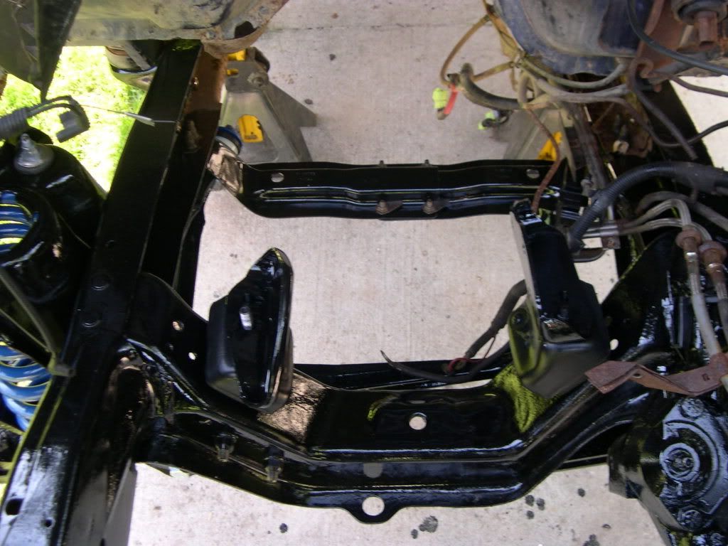

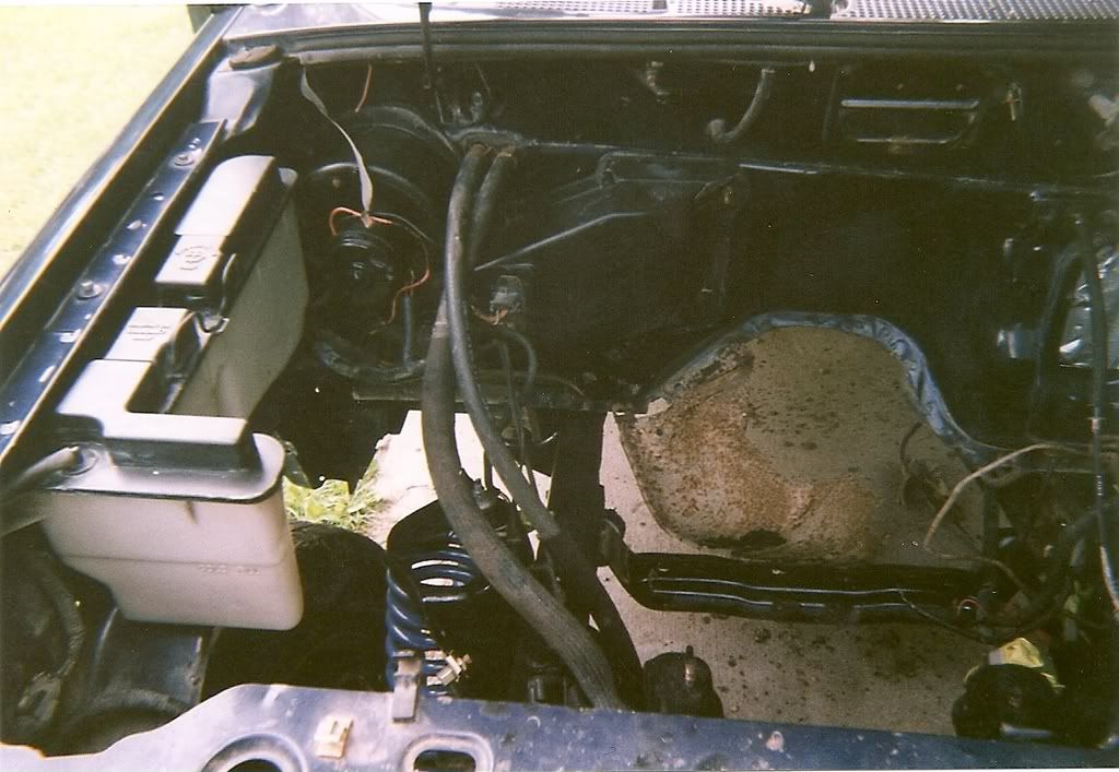

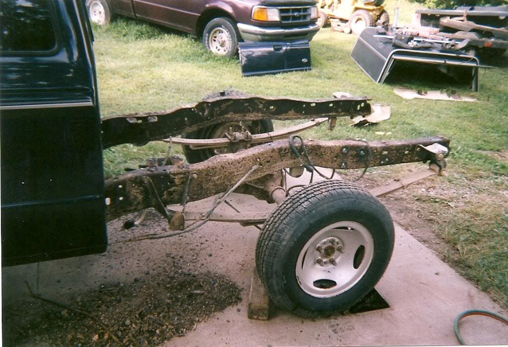

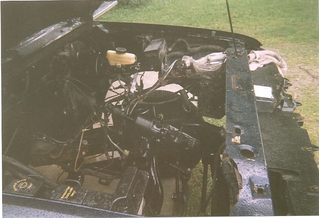

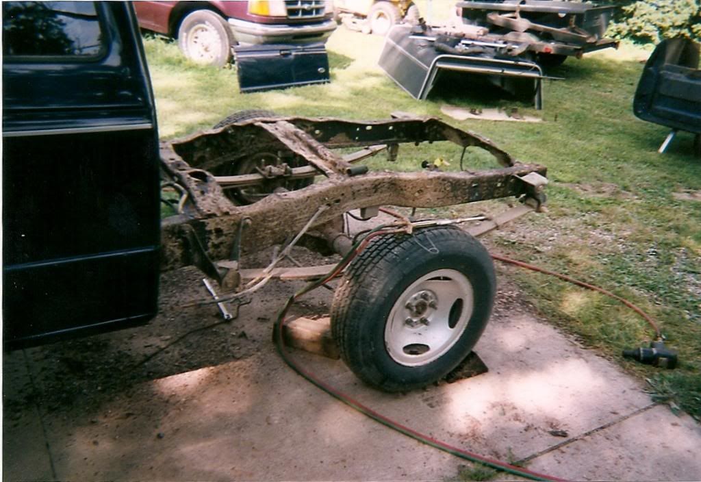

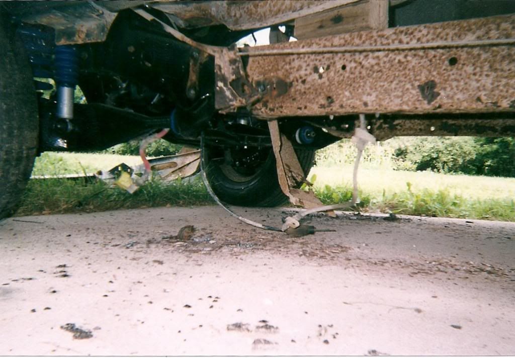

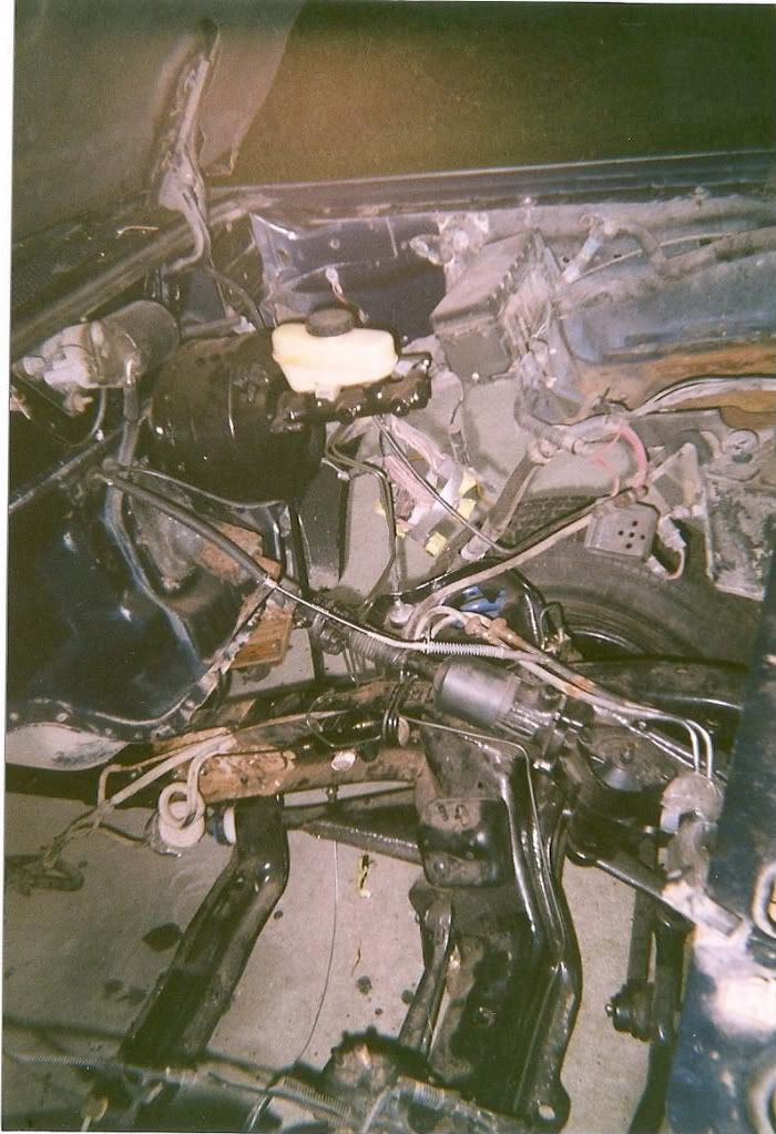

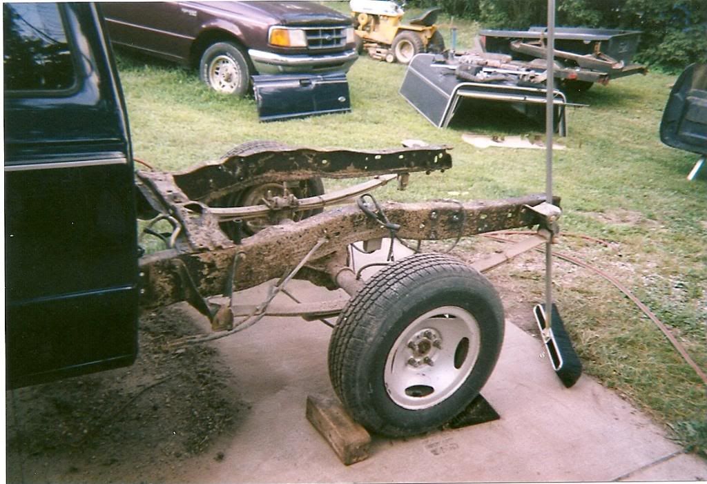

These are pictures I took in April, when I started cleaning up the front end parts and replacing all the parts that can go bad (I work at a parts store and parts are cheap so why not?) I removed every rivet holding the front end together and loaded them all into the oven (except the axle beams) and then put them into the shot blaster. I only took a few pictures at this point and sadly they were with a cell phone.

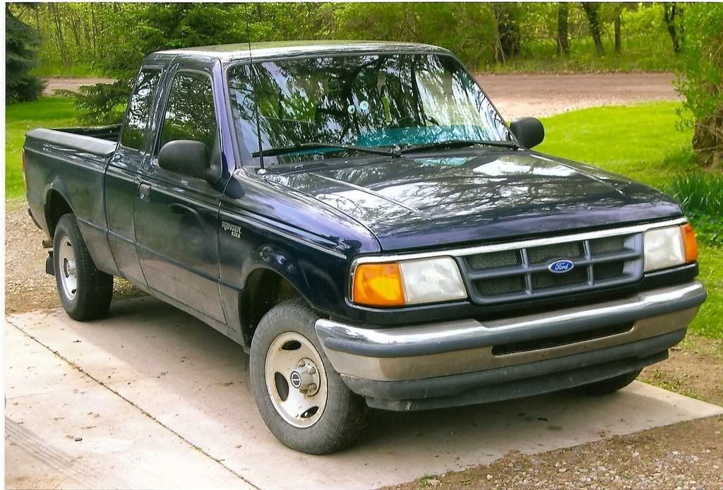

well im actually almost done with it, but i didnt get my self out of my anti- technology cocoon until i got a digital camera for christmas this year. i still have dial up at home so i do most of my "rangerstation business" at work or at the gf's house. i want to do a 2-4 inch lift on it, but since i already replaced all the suspension parts with new moog parts, i want to give it a while. my only concern is fitting the tires i plan on buying under there. i got a set of 15x8 cragar soft 8s for the truck for $100 and i want to put a set of 30x9.50 BFGs on it but i think ill experience some rubbing.

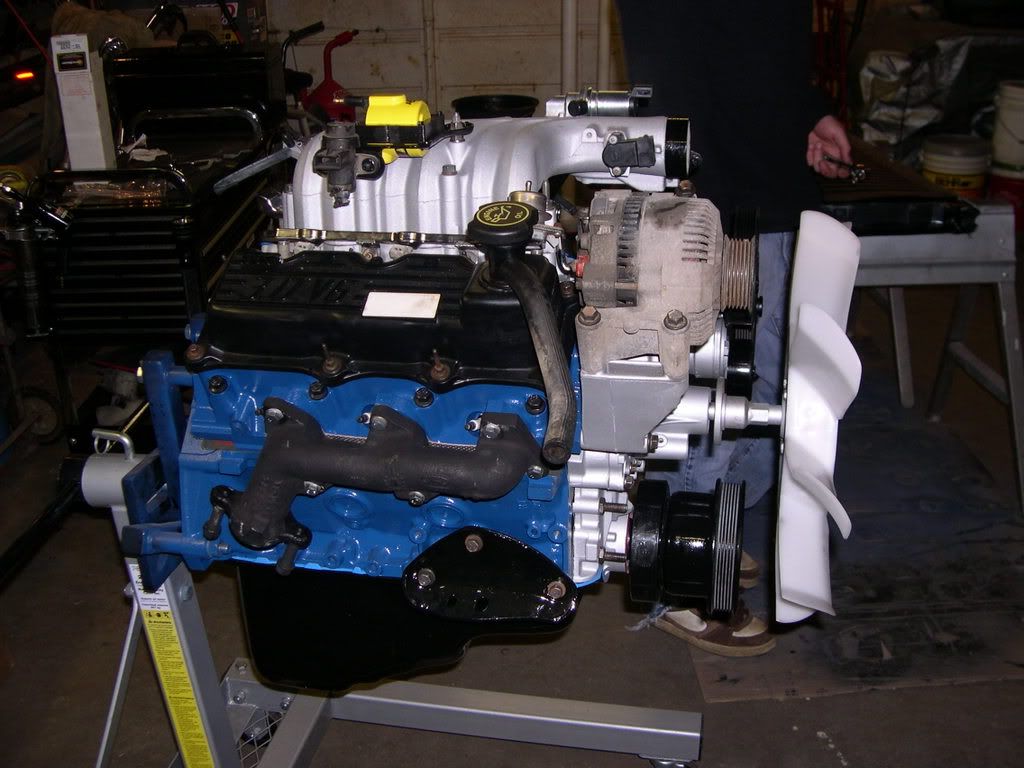

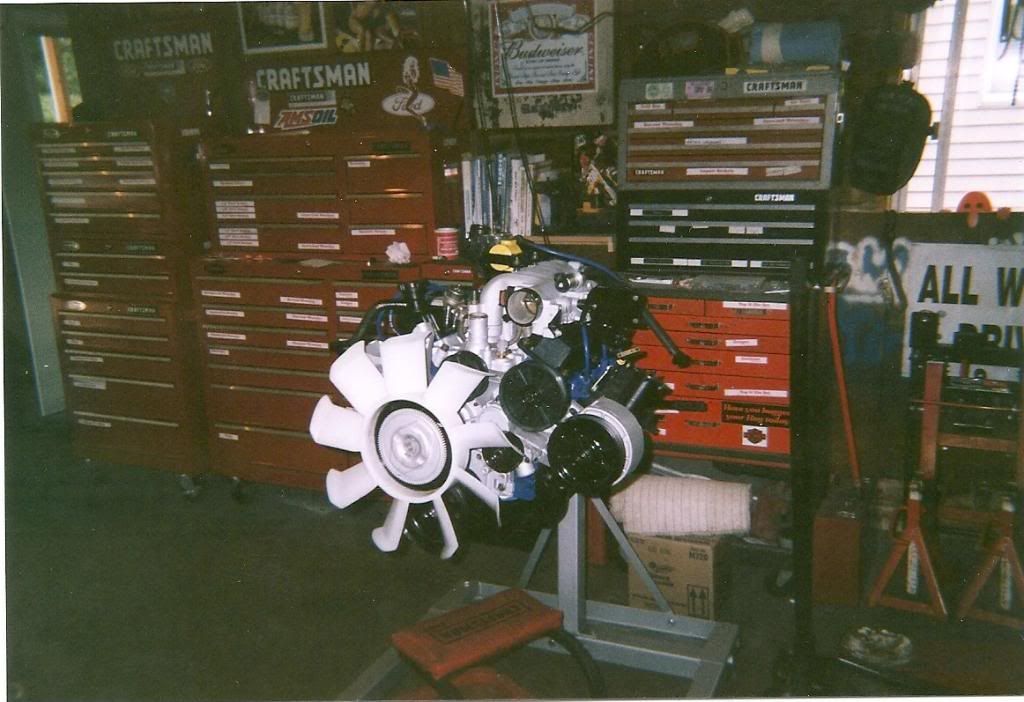

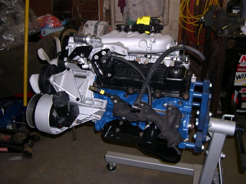

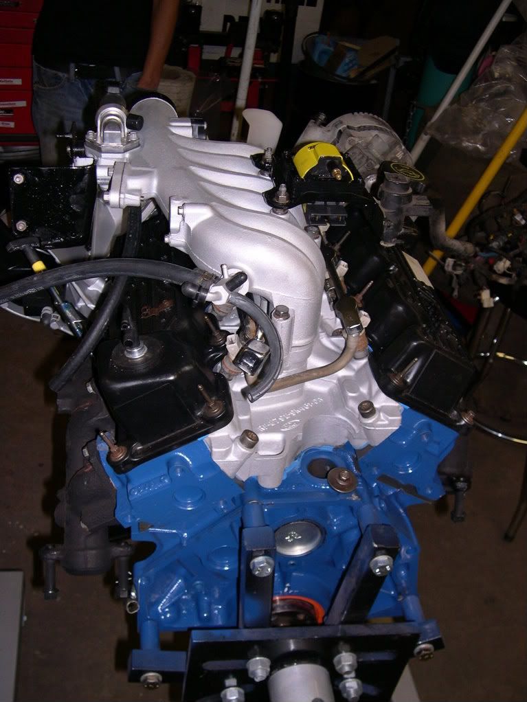

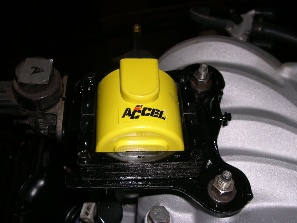

My main focus in May was to pay for all my engine parts and then reassemble it. I replaced alot of parts in the process. The oil pan, which someone had tried to patch with JB weld had to be replaced so as a precautionary measure i decided to POR 15 it as i have been doing to all my metal parts through out the build. i also replaced the pistons with silv-o-lites and hastings rings, i replaced the oil pump with a melling unit, i used clevitte rod/main/cam bearings as well as a clevitte cam with the stock lift and duration. I upgraded my ignition components to an Accel high energy coil (with cool sticker of a cartoon man being shocked on it) and 8.8mm blue high temp wires. I also used a Standard Igniton Blue Streak cap and rotor to replace the original Motorcraft parts that were still on the distributor. I doubt that I will notice any performance gains from these but the price was the same for these or the Standard igniton parts and they add more detail to the motor I think.
