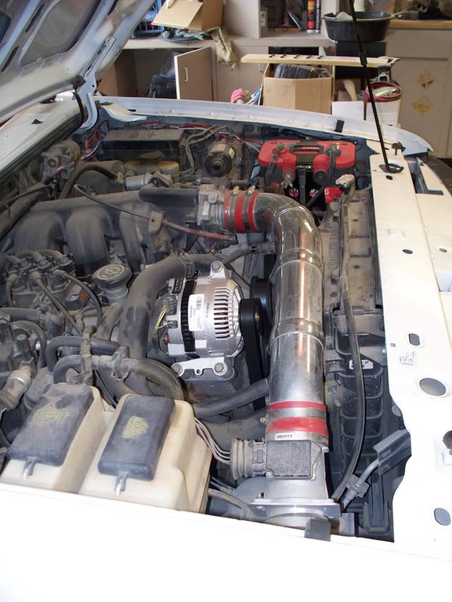

First the engine bay:
Replacing Idler and Tensioner Pulleys - 95 4.0

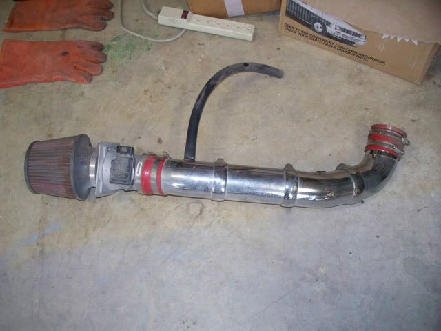

I have to remove the cold air intake first, so I get my flat head screw driver and remove the worm gear clamps on the coupler at the throttle body, remove the air flow sensor and the MAF connector as well as the hose attached to the oil filler.
Cold air intake OUT – yes the filter is dirty and has been replaced. I set the CAI aside and looked over the pulley system to see what tools I may need to take the pulleys off.

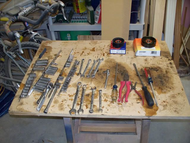

I determined I would need a 15mm socket or wrench to remove the Idler Pulley and a 1/2” socket or wrench to remove the tensioner from the engine bracket.
Tools – more than I needed, but hey I had them if I needed them.

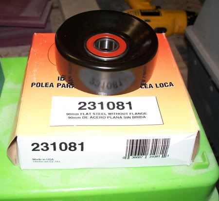

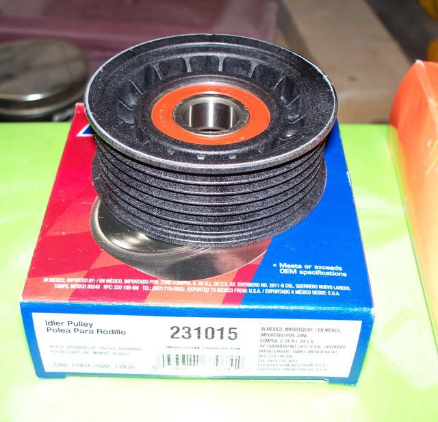

Idler:
There are no tabs/wings on the new pulley, but I am assured they are an acceptable replacement.

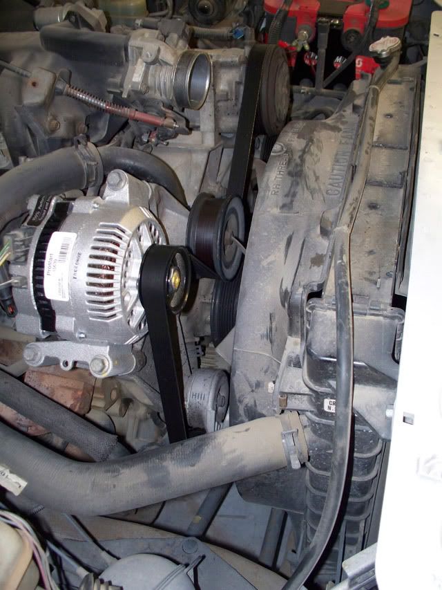

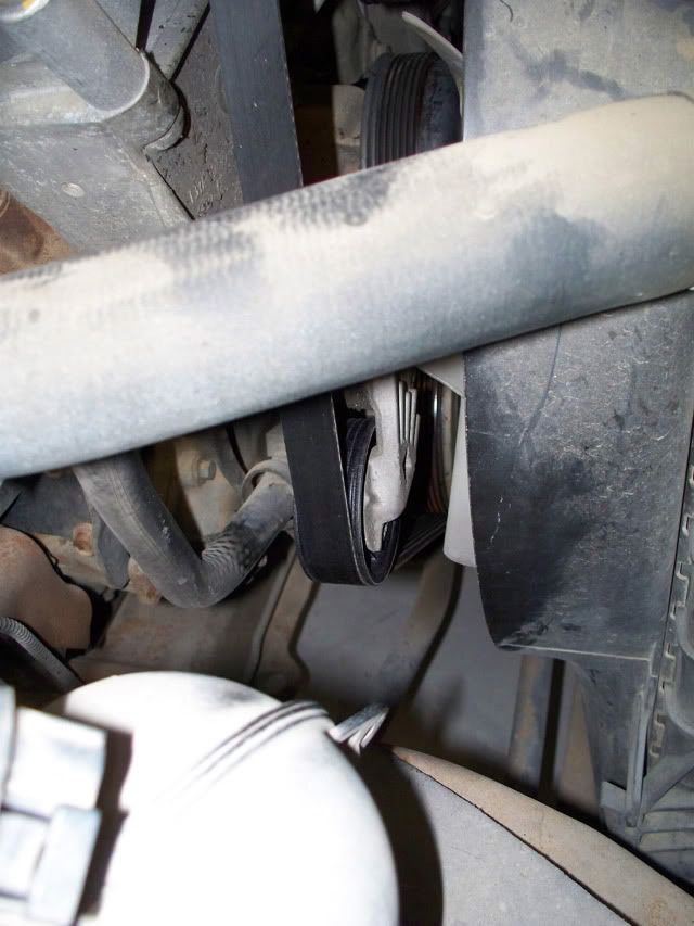

Here are a couple photos of the pulleys and their locations before I started.

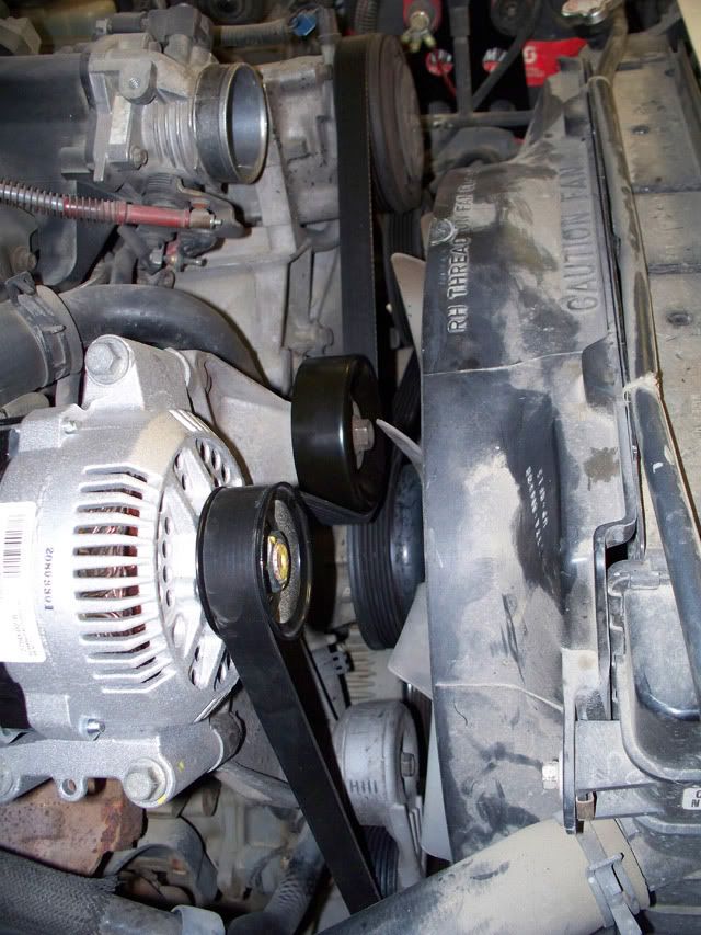

Side view of belt system – Idler is at the top

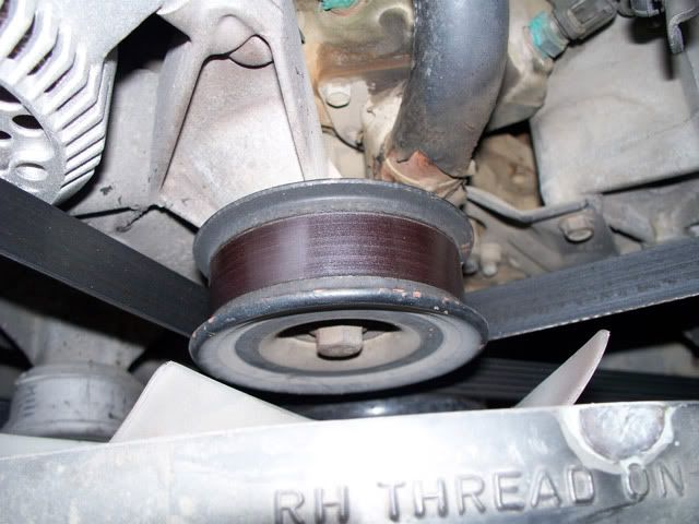

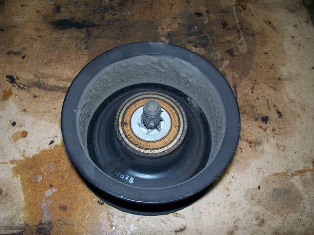

Idler Pulley:

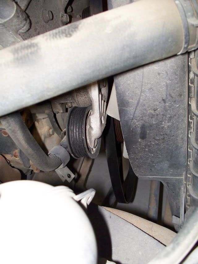

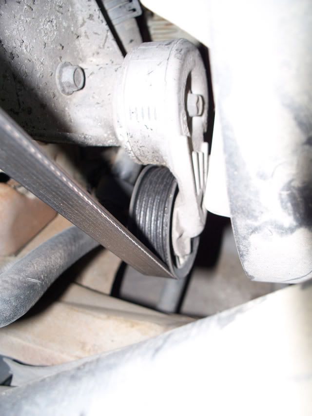

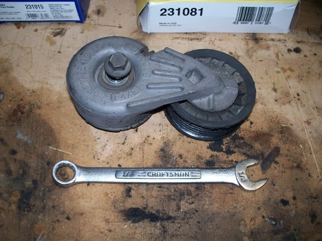

And this is the Tensioner Pulley.
Ok now you need to remove the belt, put your 3/8” Ratchet into the tensioner pulley arm and turn it down and towards the engine releasing the tension.
Below you can see the belt loosened but not removed, no need to remove it completely.

Ok now choose which one to start with and grab the proper tool to remove the pulley. I started with the tensioner pulley and arm. Again it was a 1/2" bolt head.
Here it is removed and set aside while I remove the idler pulley.

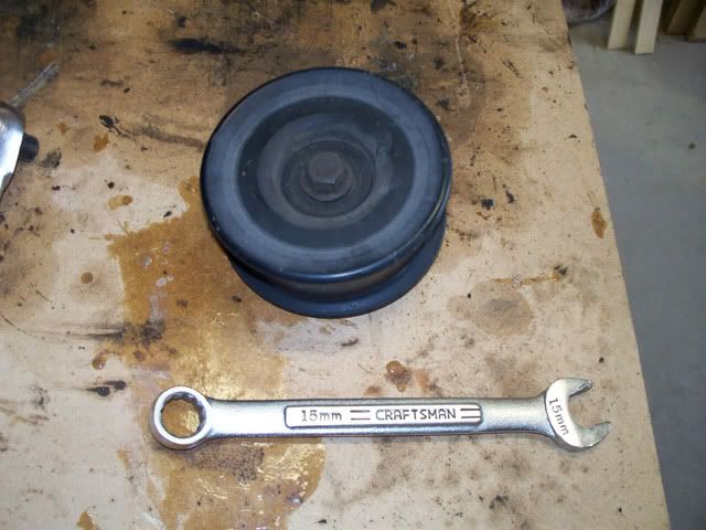

The idler pulley needs a 15 mm to remove it, and here it is removed.
Also if this is the first time the idler was removed there is a retainer spring on the bolt. You need to remove that spring (#$^@#&* - LOL).
Retainer spring/washer – remove it – no need to keep it, only a factory item to help with assembly of the engine.
Ok – now that the pulleys are off you can remove the pulley from the tensioner arm, this also requires a 1/2" wrench/socket. Mine was not that difficult to remove, I could simply hold the bracket and removed the bolt, but is may need to be clamped down in order to turn the bolt – just use caution and do not damage the arm.
Now you can begin replacing the pulleys in their correct location. I do not know the correct torque settings, but for mine they are simply “tight” – LOL. Make sure when you install the idler pulley that the bolt is installed correctly – the pulley should ride on the large shoulder of the bolt not the threads.

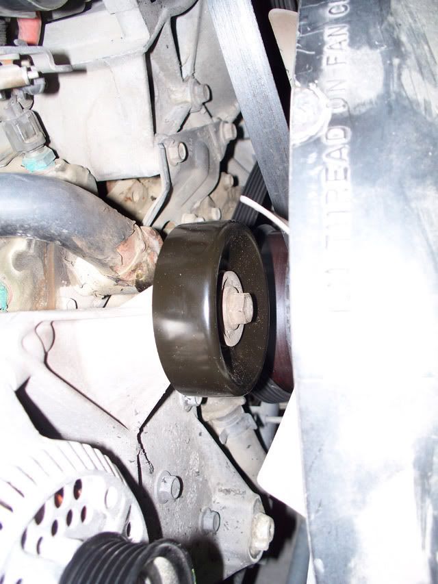

Here are some shots of the new pulleys in place and the belt installed . . .

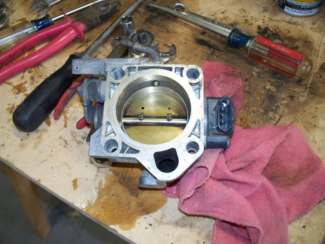

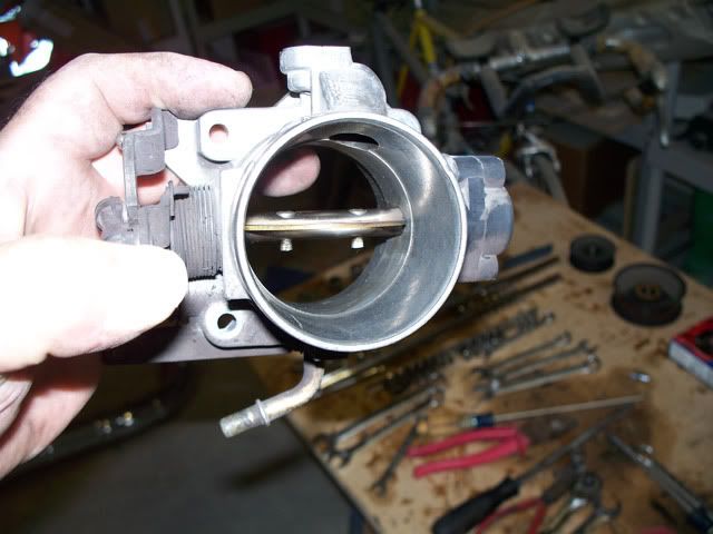

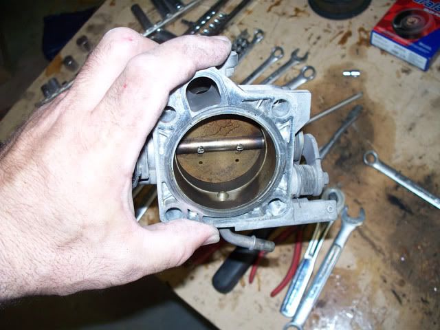

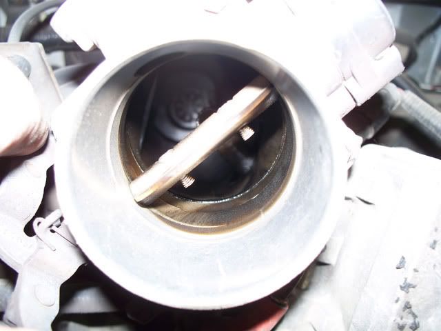

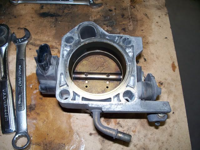

Now that the pulleys are replaced I began to work on the throttle body. First you need to remove the throttle cable – it just pops off with a screwdriver.
There are 4 bolts holding the throttle body in place - remove them. Also remove the throttle position sensor and a small hose on the underside – once the throttle body is removed from the intake, you can see it under the throttle body in one of the pics - orange hose.
DIRTY THROTTLE BODY

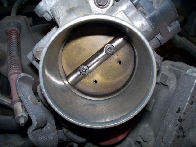

I used a shop rag sprayed down with WD-40 and it wiped out pretty easily. You can use intake cleaner such as that from Berrymans, but I have been told not to before as it can remove the gold coloring from the butterfly.
Here she is all cleaned up and ready to reinstall . . .
Ain’t she purdy . . .
That is all there is to it. Make sure everything is re-installed and the belt is in position. Start her up and go over it one more time to make sure everything is correct.
