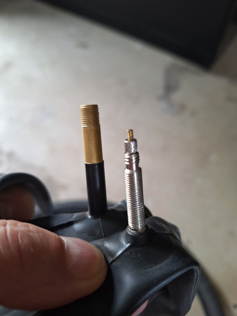

Yesterday I decided to air up the tires on my bicycle and get it ready to ride. I have a hybrid with 700 - 38C (28 x 1-5/8 x 1-1/2) tires and they were flat from sitting and not being ridden in 2-years. Seconds after airing up the front tire the innertube exploded. I only aired it to 60 psi, below its max psi. I had another wheel/tire and stuck it on, and this time only aired it to 45 psi. Again a few seconds later the innertube exploded. It ripped a 17-inch section of innertube open. WTH? The only thing I could find online is that the inner tube could explode if it's pinched between the tire and the rim.
Has anyone ever experienced this? How am I supposed to air them up without them exploding seconds afterwards???

Two different wheel/tire/tube sets and the tube in both exploded? If so, it would rule out a puncture thru the tire, or, a sharp edge in the rim.
I always had problems where the spokes came thru the rim. That's what the duct tape, or professionally rim tape, is for. To keep the tube from rubbing on something sharp.
Two years of no use and dry rot could be a factor.
You pumping these by hand with a bike pump?
My SWAG is oxidation of the rubber, or whatever its made of. Same thing happens to rubber bands, the oxygen attacks the rubber and it deteriorates.

I'm pumping them with a hand pump. I ordered new heavy duty innertubes (thicker material) that should be here tomorrow.
I've had that happen with old inner tubes. It's just old age.

Internet is probably pretty close - the tube gets pinched between the rim and the tire. As you add pressure it gets to the point where it fails.
To prevent it; you put just a little pressure in the wheel (maybe 5psi) then go around the tire pushing it in with fingers (tire should still be soft enough to press off the rim) to make sure the tube isn't pinched. Once confirmed, inflate to pressure.
The second part of the process is to make sure the tire is centered on the rim. Bicycle rims don't have a "ledge" for the tire to sit on like automotive tires. So, you can have the case where the tire isn't concentric with the rim. And if the tire is barely on the rim when you inflate, it pops of which is very detrimental to the tube (your 2nd example sounds like this).

In my experience, what works best is to put the inner tube in a Ziploc bag with some talcum or baby power and shake the bag so the tube gets coated. The powder will help the tube from binding in the tire and the rim so it moves and slides better.
Like previously mentioned, air up the tube a little bit after it's in the tire helps get everything in place. The check to make sure the tube isn't pinched and the tire is seated properly.
When working with the tire, use tools that are not sharp or have corners. I find small box end wrenches work well for this.
Once everything is set, then you can pump up the tire the whole way, check to make sure the bead is seated on the rim periodically as you go.
