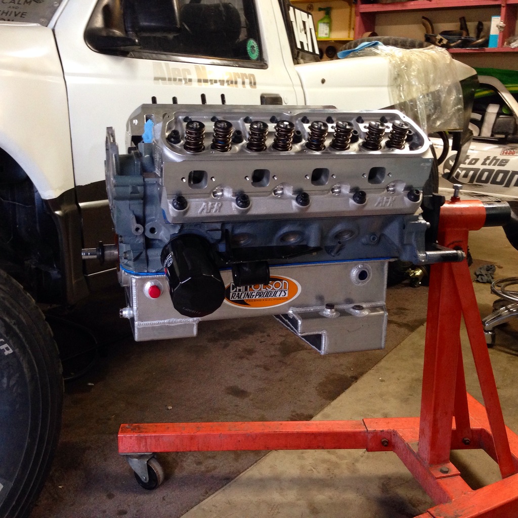

As it currently sits it is powered by a 302 roller motor punched out .030 over, all forged internals with some truck machine work, AFR 185 heads, Edelbrock Intake, Holley 750 carb and completely custom stainless exhaust. Last time truck was dyno’d it made well over 300Hp to the tires.
Has a cast iron Top loader 4 Speed with hurst shifter, McLeod hydraulic throw out and a custom clutch.

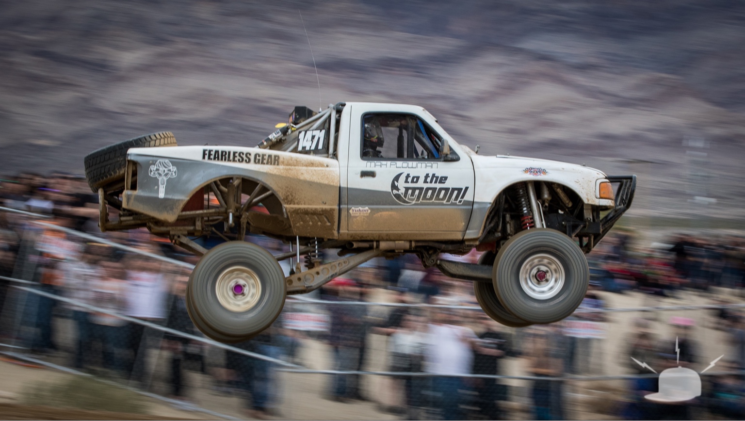

Front suspension is custom equal length beams with crossover steering. Has 2.5”x 14” coil overs, 3.0”x14” triple bypass shocks and 2.0 hydraulic bump stops pulling about 19” of travel.
Read suspension is a custom 3 link with 2.5”x14” coil overs, 3.0”x16” triple bypasses and 2.5 hydraulic bumps pulling 26” of travel using a sway bar.
The truck got its name of To The Moon after we attended a jump contest in pismo and I joked about going to the moon, even using duct tape to write in on the door. After jumping over 120ft at that event it made it in several magazines and the name stuck and evolved in the graphics you see on the truck today.
