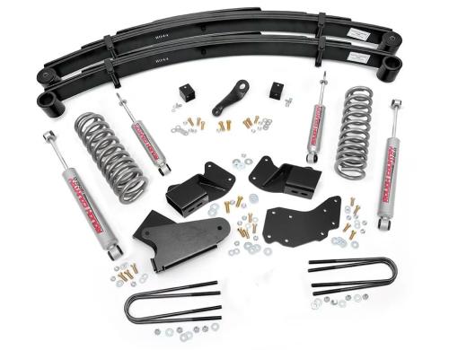

Rough Country Suspension Lift Kits:
Rough Country offers 1.5-inch leveling coils, and a 4-inch suspension lift kit. The 4-inch kit can be purchased with or without replacement rear leaf springs.
TRS Note: This kit uses a drop plate to lower the passenger axle beam pivot bracket. Refer to the ‘Beware Of Drop Brackets” section at the top of this page.
