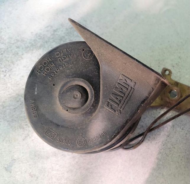

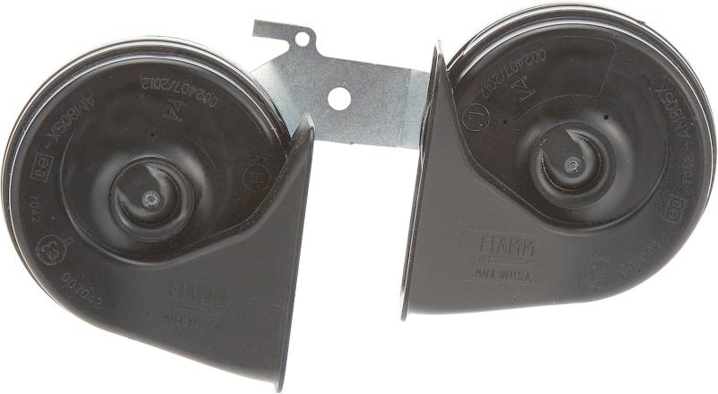

Horn from Ford Crown Vic, Grand Marquis, etc… (you are looking for horns with AM80S on them)

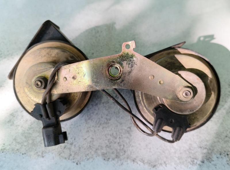

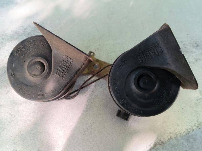

Now the horns you will be installing should look something like this…
In order for the horns to fit properly, you will need to undo the nuts holding the horns to the bracket and switch their positions. The 10mm socket will be used here. (Horn on left is removed and mounted on the right and vice versa)
Be sure to check fitment and ensure the horns will fit, as well as ensuring no electrical connections are pinched. Then, tighten the horns down.
