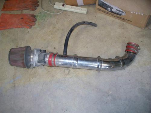

I have to remove the cold air intake first, so I get my flat head screw driver and remove the worm gear clamps on the coupler at the throttle body, remove the air flow sensor and the MAF connector as well as the hose attached to the oil filler.
Cold air intake OUT – yes the filter is dirty and has been replaced. I set the CAI aside and looked over the pulley system to see what tools I may need to take the pulleys off.

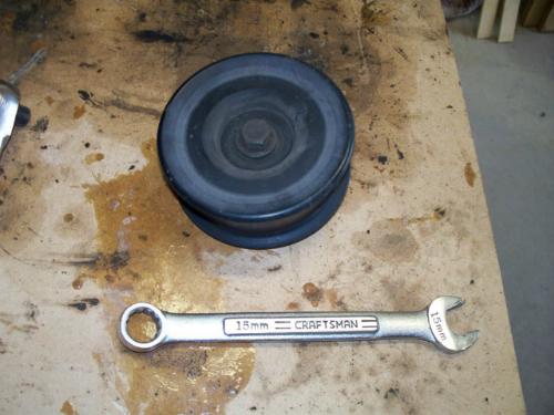

I determined I would need a 15mm socket or wrench to remove the Idler Pulley and a 1/2” socket or wrench to remove the tensioner from the engine bracket.

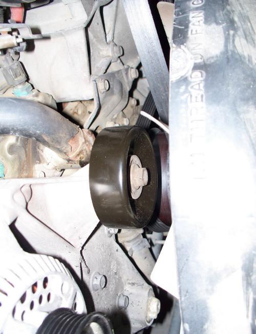

Here are a couple photos of the pulleys and their locations before I started.
Side view of belt system – Idler is at the top
Idler Pulley:

The idler pulley needs a 15 mm to remove it, and here it is removed.
Also if this is the first time the idler was removed there is a retainer spring on the bolt. You need to remove that spring (#$^@#&* – LOL).
Retainer spring/washer – remove it – no need to keep it, only a factory item to help with assembly of the engine.
