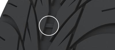

In addition, tires have wear bars molded in to the tire. If the tire is worn down to the wear bar, then the tire is considered to be bald, and no longer useable.
Tread wear bars
The Super Swamper Irok has the wear bars molded in to the tread.
