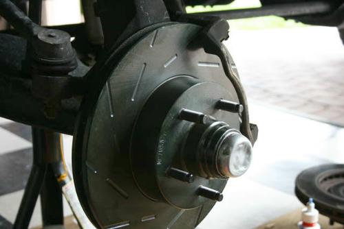

Here is the install of EBC USR rotors and EBC Yellowstuff pads onto my 2002 2wd Ranger Edge.

Pack and install your new outer bearing just like the inner. Apply a decent amount of grease to the spindle and slide the new rotor on. Now put the old washer back on and thread the retaining bolt on by hand.

Reinstall the caliper bracket, I used a little bit of blue Loctite on the bolts since they were pretty loose when I took them off.
Put the new pads in place.
Put the caliper back on and bolt it back down. You will have to most likely push the pistons back in to get it to fit. This can be done by placing an old pad over them and then using a C clamp to push them back in. Be careful, brake fluid may come out of the reservoir when you do this.
