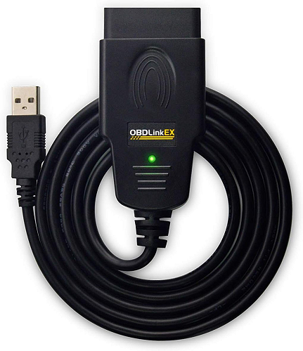

NOTE: The ELM327 the fastpakr linked to is no longer available. I’ve been using the OBDLink EX FORScan OBD Adapter shown below.
