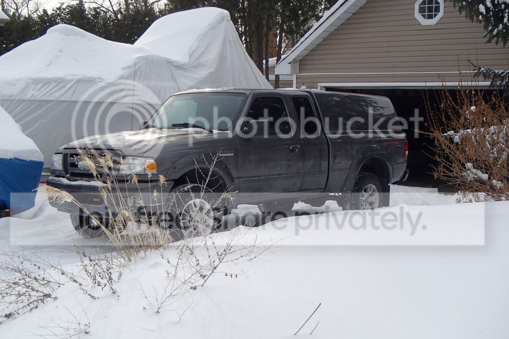

Hi All, so I finally found myself a good deal on a 2007 Ranger extended Cab sport 4x4 with a blown transfer-case.

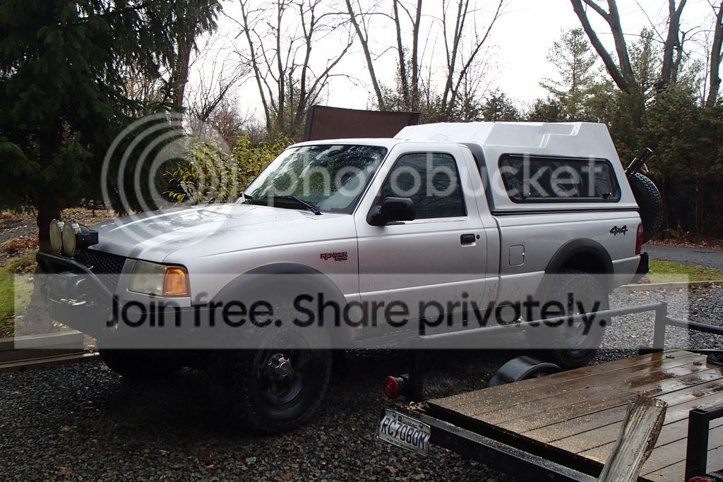

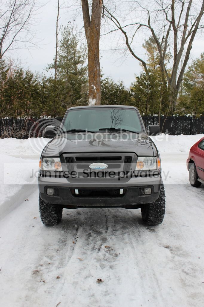

Some of you may have seen my silver 2002 Ranger regular cab around the forum before, but if not here are a couple pictures of her;
Plans are to go along the same route ; (lift, tires, bumper, front and rear lockers, cb, etc.)

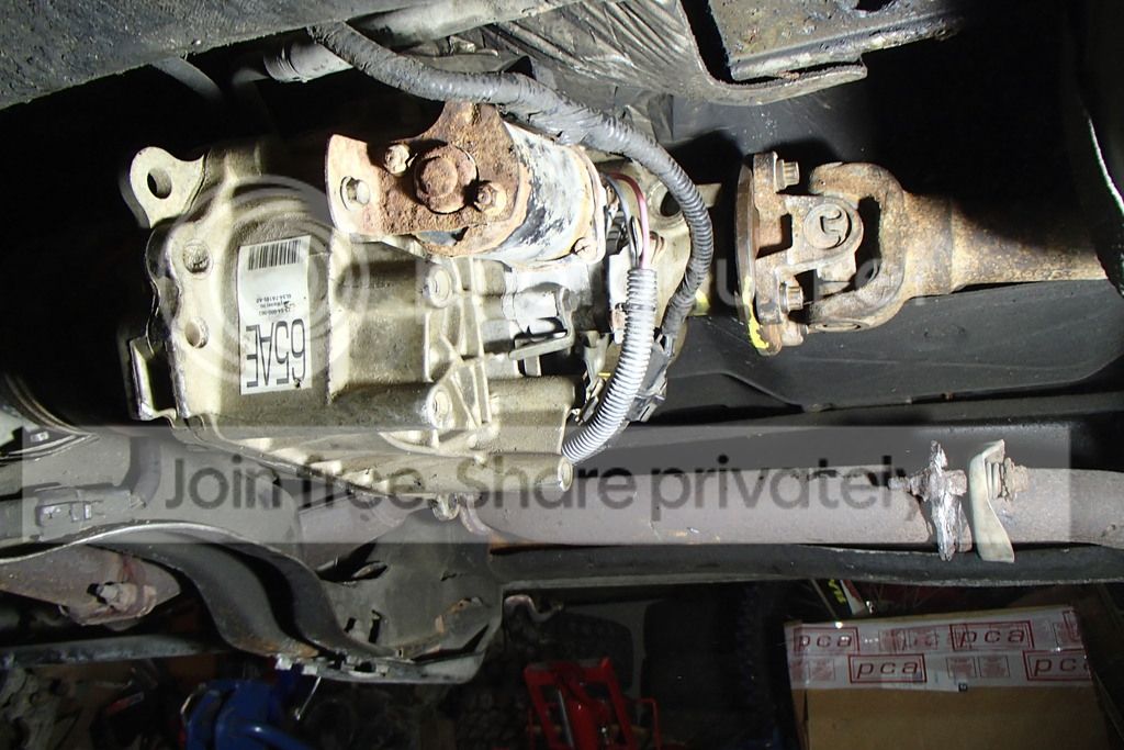

I got the step-bars taken off and the transfer-case out the other day.
What a PITA that was. I could get maybe one tenth of a turn at a time on the two bolts up top, so it took a little while in the freezing cold. Thankfully they were not seized. Got myself a 13mm gear wrench, so hopefully install will be a bit quicker.
It's been so cold around hear lately averageing between -20 and -30 celcius (-4 and -22 farenheit) the past week I haven't been motivated to work in my freezing cold garage.
It's starting to warm up a little bit, so tomorrow night I hope to get my new used transfer-case in, driveshafts mounted back up and then start working on the suspension.
This time decided to buy actual torsion keys because I don't like the amount of bolt that's pushed in when the T-bars are cranked with stock keys. I'm curious to see if it will ride different at all than the other ranger with cranked stock keys (it shouldn't)

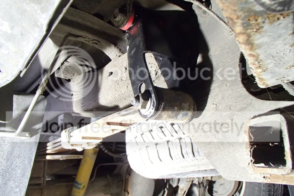

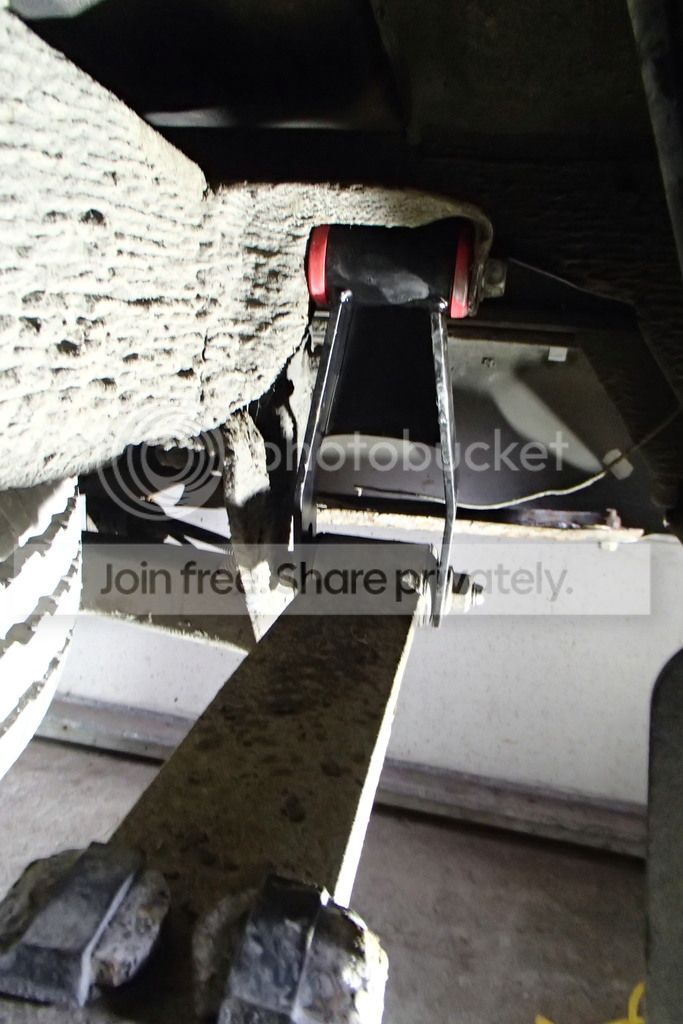

I'll also install my extended shackles.

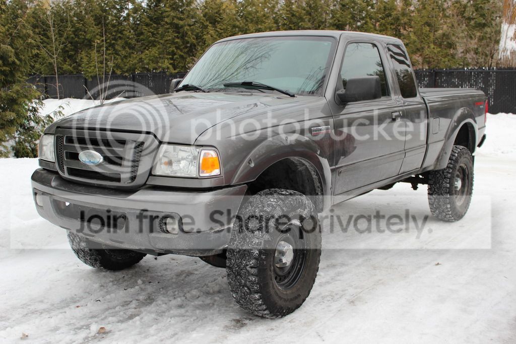

Update;
- Transfer case is in
- Shackles are on and torsion bars have been cranked within reason.
Looks a little bit meaner now.
I bought some Swivel head gear wrenches to reinstall the transfer-case and I'm so glad I did! It made a bolt that previously took almost an hour to uninstall take around a minute to reinstall. Well worth their weight in gold!

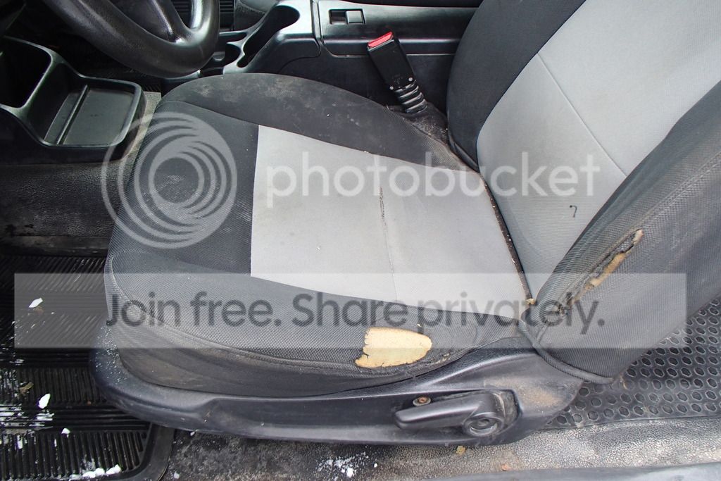

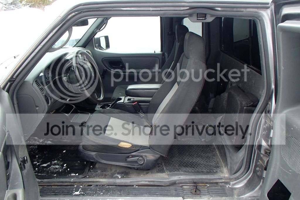

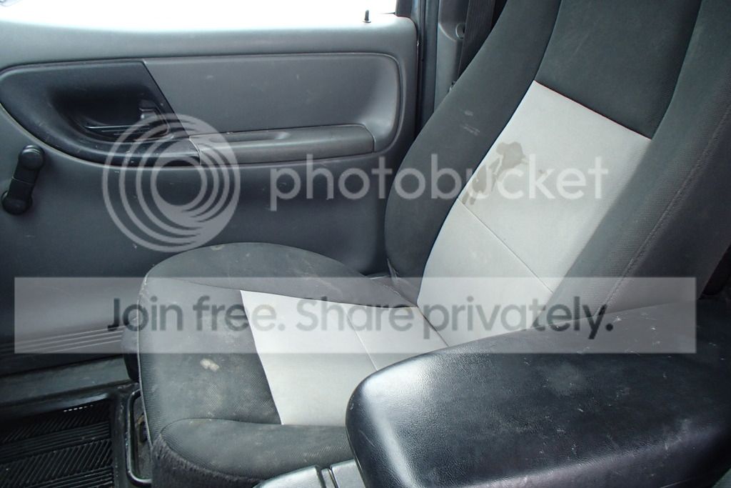

I bought the truck despite the state of the interior, knowing I could get it back to being presentable (it’s actually really just the seats that are in terrible shape, the rest will clean up nicely)\
I got a hold of some seats from an 05 ranger in much better shape, not perfect but will do the job nicely , pics to come.
I will be replacing the buckets with what can only really be referred to as "Bench-Buckets", not really a bench seat, but also not really a bucket.

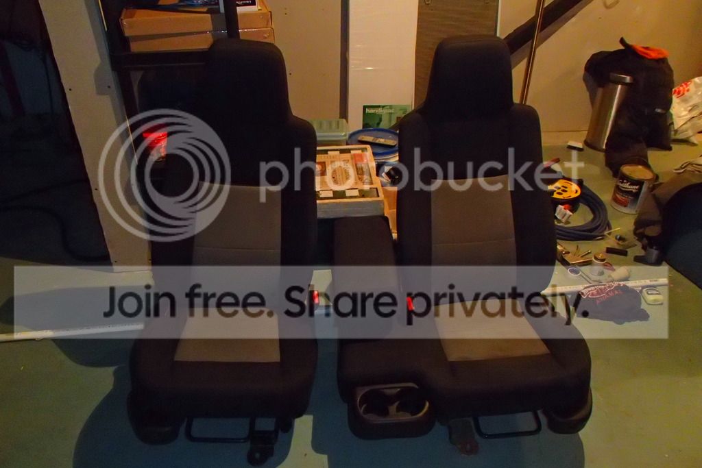

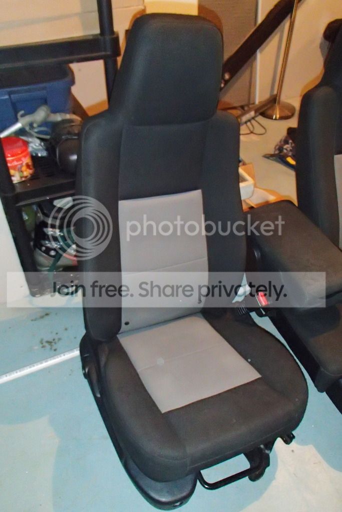

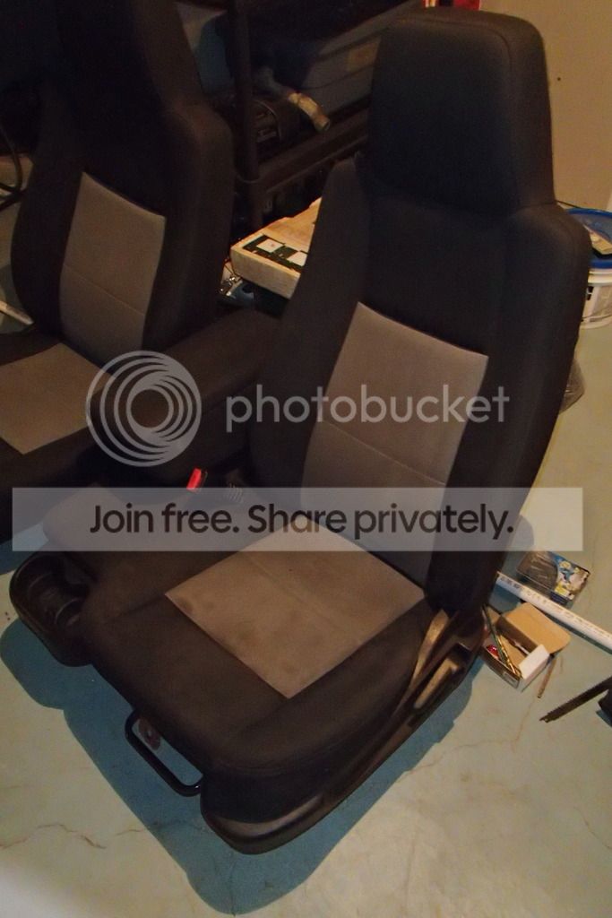

2. Cleaned up the junkyard seats that I picked up from an 05 ,the passenger side is like new, where as the driver side still has a few small stains.
I think I can still clean it up some more, but for now I at least don't feel like I'm getting dirty every time I touch it.
I will need to transplant the seat wiring harnesses from the 2007 seats as they are different, but it shouldn't be too big a deal. The main difference is the presence of a passenger load sensor for the passenger airbag.

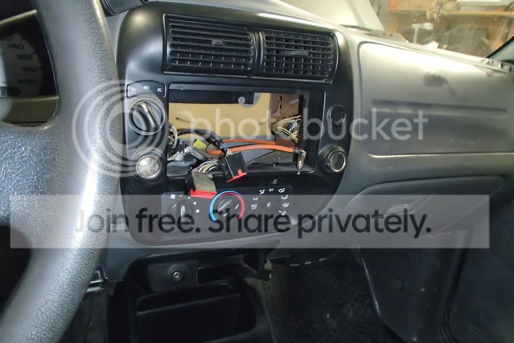

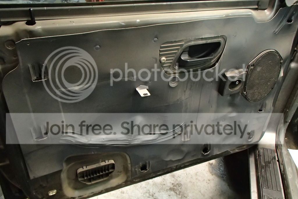

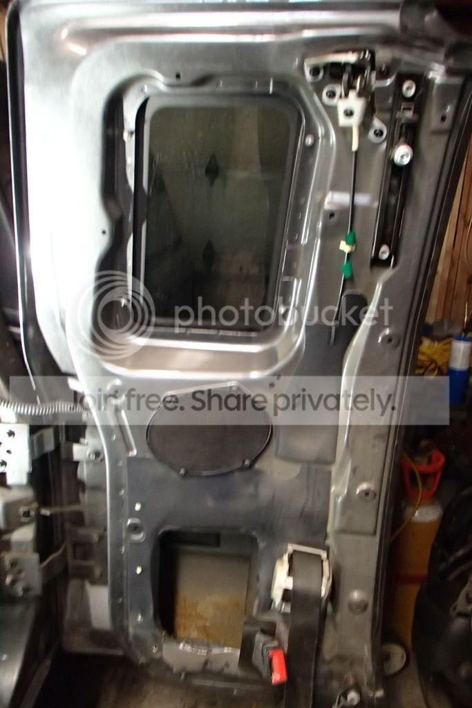

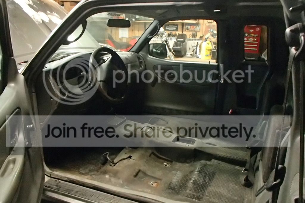

3. Washed down the whole interior and started prepping it for the new speakers/radio and replacement seats.

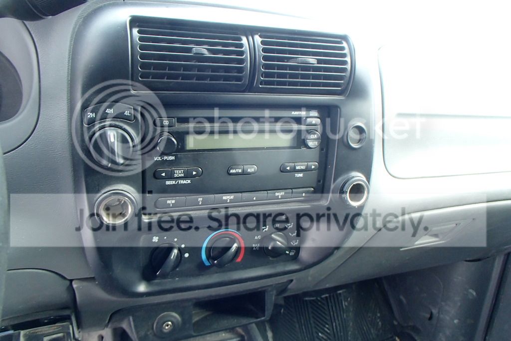

The Stock radio is out,
Door panels are off
Front seats are out
I ran into an issue however that I didn't expect. When I removed the center console (which will not be going back in) I realised that there were two large square cutouts in the vinyl floor for the console mounting... I wasn't expecting this, I just expected a couple small bolt holes. I will have-to get a replacement vinyl floor from a non bucket model ford ranger to fix this issue. I also noticed the jump seats were starting to tear in some areas, so I'll be on the lookout for some replacements. I don't need the interior to be perfect, but I at least need it to be presentable with no rips/tears.
Next up, I will be removing the jump seats and vinyl floor in preparation for their replacement, and starting the body lift.

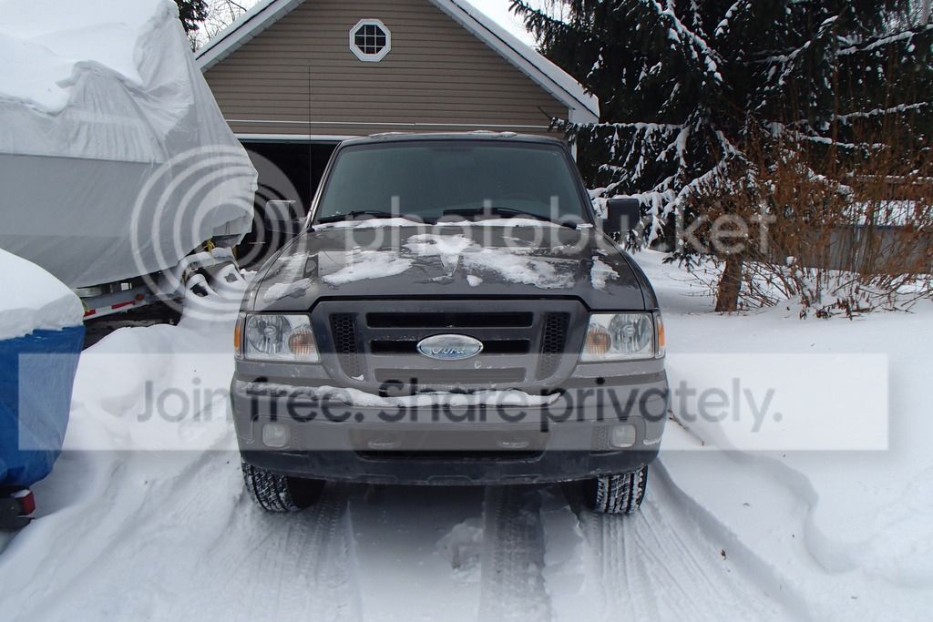

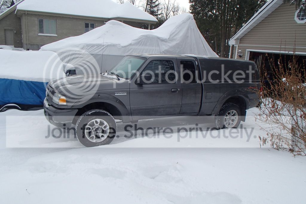

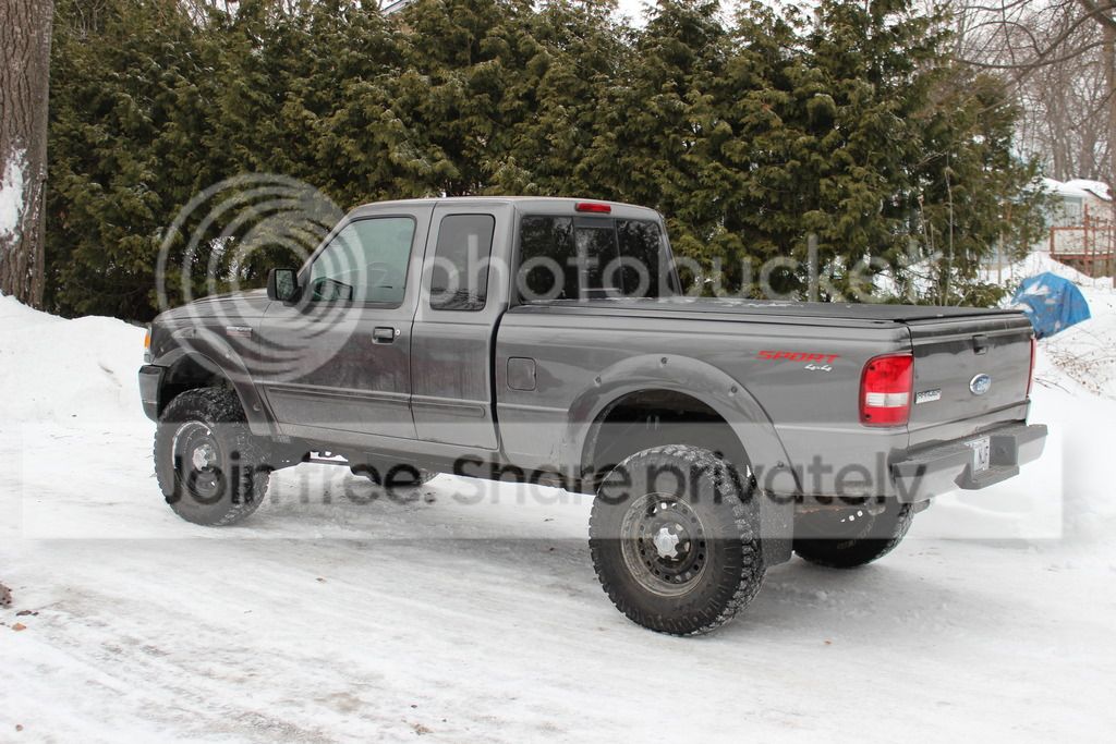

Well, got a lot of work done this past week! 3" body lift is complete, and I honestly can say I'm in love with the look, I couldn't be more satisfied.
For anyone doing a body lift on a ford ranger, the performance accessories kit is very good. Was only missing one extension for the gas tank vent hose (one in the kit didn't fit) and I think one nut was missing for the front bumper bracket.
As you can see, I also swapped over my winters from the silver ranger, as well as my wheel spacers. As I said before, loving the look and the lack of tire rub when reversing.
I just have-to modify my tow hitch so I can put it back on. otherwise it would be hanging down like crazy.
Interior is also complete, installed my Kenwood radio/speakers, vinyl floor from a non bucket 2009 ranger, new used (05) drivers seat, passenger seat, and rear jump seats.
Basically all the fabric interior has been replaced with pieces in better shape. Will get some pics once I've cleaned it up a second time.
