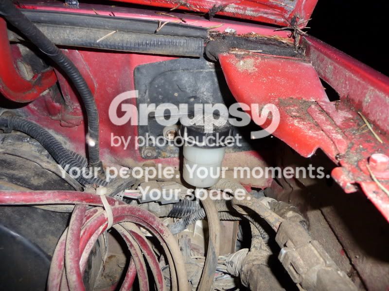

This is the clutch fluid resevoir. Obviously, I already have it attached to the firewall of my truck. It holds the fluid for the hydraulic clutch, and prevents any air from getting in. The holes for it are already in the firewall; all you need to do is bolt it up.

-Does anyone know if I need to pull the wiring harness for the manual transmission that attaches to the transmission sensors on the top cover as shown above? I still have that harness from the manual truck and I believe it is still attached to the engine which I also pulled from the donor vehicle. Is this a neccessity, or are the plugs I need already on my truck which had the automatic?
-There is an electronic port on the side of the clutch interlock switch that goes up under the dash that I have no idea what plugs into it. Does anyone know what plugs in there and if it will be in the wiring harness for my automatic?
-Does anyone have a specific rebuild kit that they recommend? I'm looking for a good one right now.
Again, any and all help, advice, criticism is appreciated.

You will need the wireing harness for the manual. When I swapped mine there was a little sub harness if you want to call it that that plugged into the engine wireing harness at the back of the engine and ran down the top of the tranny to the two sensors.
The interlock switch plug is up under the dash whether you have a manual or automatic I want to say that there is a jumper plug on the end of it if you have a automatic, but doent quote me on that I never put a interlock switch on mine. You do not have to swap the computer it will work without but the check engine light will stay on.
Some advice from someone thats done this bench bleed the master and slave I didnt and it took 3 days to bleed on the truck.( You basiclly cant bleed this setup you just have to leave it sit and let gravity do its thing) I would recommend buying all new slave and master. I belive the last time I was in O'Reilly's they sell them prebled and ready to install.
I would not reuse the slave no matter what if it goes out you have to repull the tranny to replace def. worth $60-$100 now.
