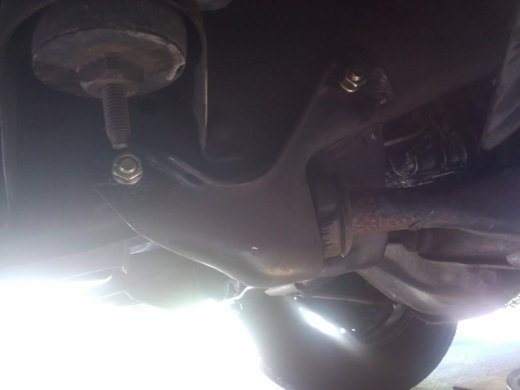

Most likely radius arm bushing. You can usually tell if they're bad just by looking at them. This is what mine looked like before replacing them. Note the big chunk missing:

Quote:
Could also be a bad shock.
