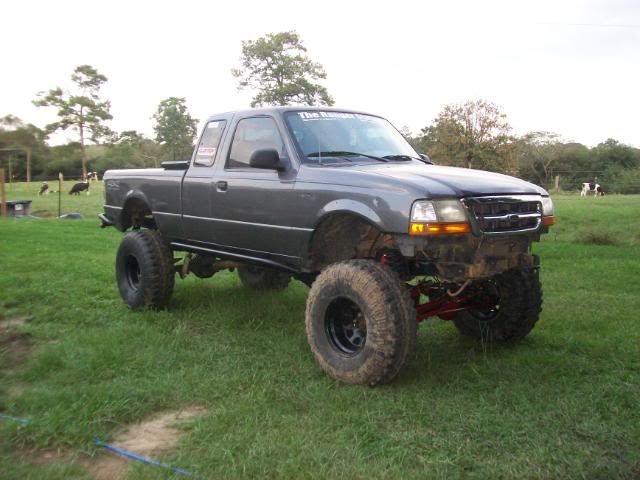

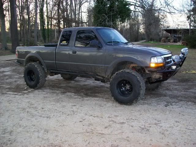

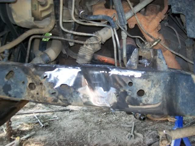

Well it has been a busy couple of months. I am almost finished with the SAS on my 99 ranger. It started out because of cheap wheel bearings, one came apart and f-ed up pretty much everything on the drivers side. It was going to cost around 2 grand to fix the IFS so I said screw it and started on the SAS. I used a D30 out of a 96 model XJ. I then started striping my 90 model Ranger, which had a 6 inch skyjacker lift on it. I used the upper coil mounts, coil springs, shocks, steering head and the rear blocks from it. then I started striping the 99, it was a long very educating experiance. Heres some pics, be easy on the critisizm. Some things like the Y-liinks will be re-done when people start drinking more milk, I work on my inlaws dairy farm and times are tough right now.

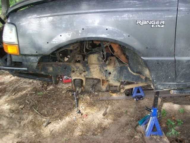

everything taken out
cleaning up the frame

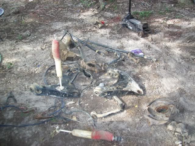

a pile of parts

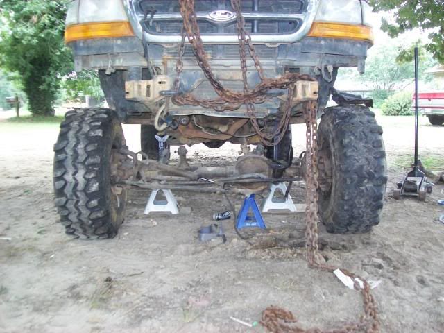

front end under truck

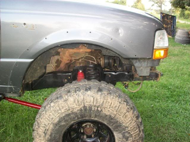

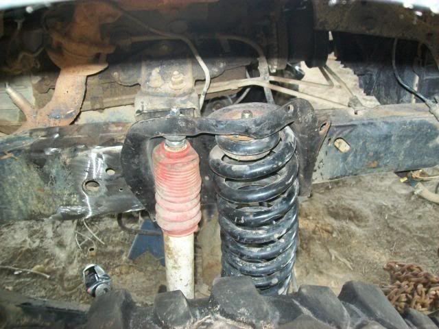

coil mounts welded to frame

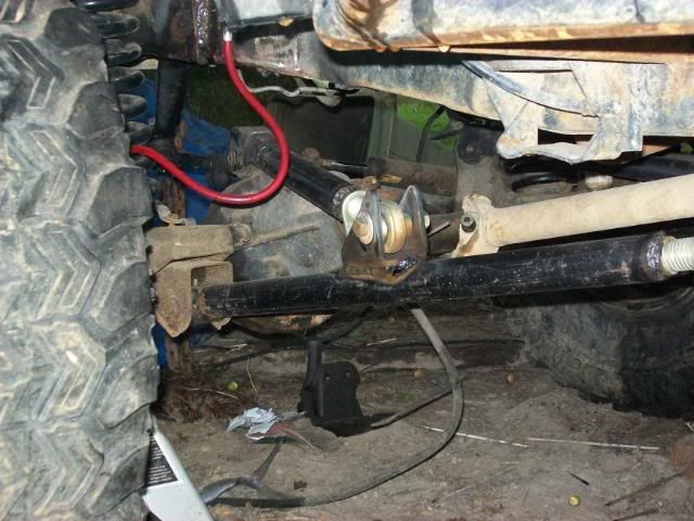

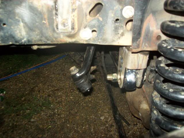

y-links done

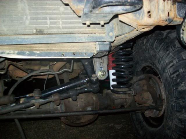

hard to see but its the track bar
on 36 inch TSL radials, and painted

Looks like you did a hellava good job to me.

i guess i dont understand but why did you need a track bar with the y links?

Y link is still a radius arm setup, and only 2 links square to the frame means you need a third to keep it parallel and keep the axle from sliding around under the truck

^^^ thats link what i thought but wasnt sure

What all is left? Engine crossmembers? Steering tweaks? How'd you mate the 98+ steering shaft to the new box?
I really like the height....Not too big...not too small. Just right. I plan on building mine to clear 37's just fine on full widths, but running 35's. Trying to keep CG down a little bit. My buddy's got an 07 Ranger on 40's....TOWERING 40's. I have a feeling I'll get a text of it on it's roof this winter. :(

Looks pretty decent!
One thing I can point out is that it looks like you don't need the dropped pitman arm on there anymore. You want your draglink to be at the same angle as your track bar so it doesn't bump steer.
