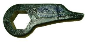

Ford Ranger torsion key
Ford P/N F57Z5B328B
The ‘Pre-Key Mod’ consists of taking a set of torsion keys from a 1998-2007 Ford Ranger 4×4 and installing them into a 2008-2011 Ford Ranger 4×4 to gain 1.75-2.00 inches of lift. You then use the earlier (1998-2007) rear axle lift block, or a longer set of rear shackles (Belltech 6400) to raise the rear.
Make sure you have the vehicle re-aligned after changing out the torsion keys.
Ford P/N Description
F57Z5B328B 1998-2007 Torsion Bar Key (Adjuster)
8L5Z5B328A 2008-2011 Torsion Bar Key (Adjuster)

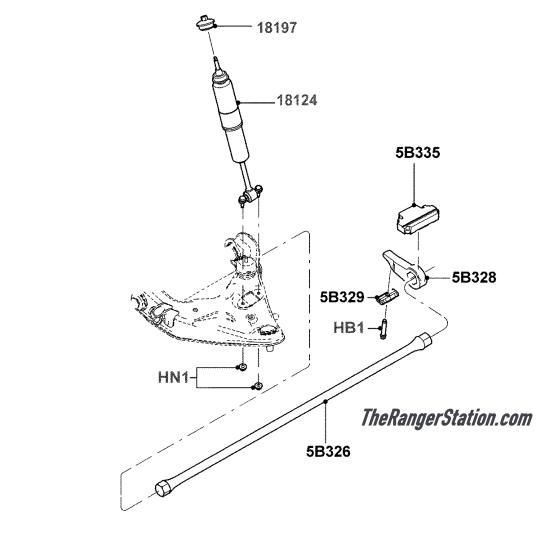

Ford Ranger torsion bar diagram
Want information on removing the torsion bar key (adjuster), click HERE.
