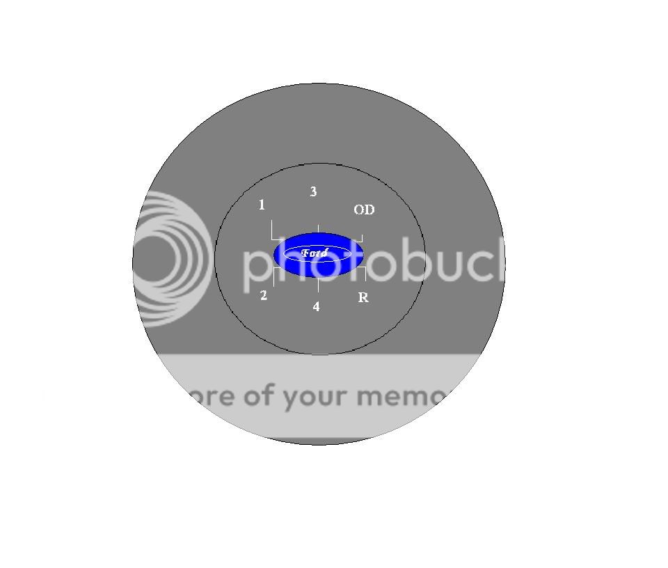

What design should i put on my diff cover
  • Blue Oval
    Votes: 8 100.0%
  • A face (gimme more specific ideas)
    Votes: 0 0.0%
  • Words (gimme a specific idea)
    Votes: 0 0.0%
  • Other (gimme a specific idea)
    Votes: 0 0.0%
  • Total voters
    8
  • Poll closed .

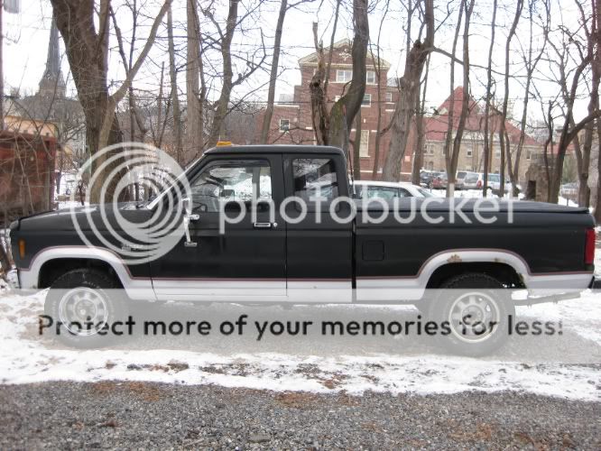

Well, unfortunately I don't at this moment have a before pic of my truck. Also don't have many pics of the work I've done so far, but I guess it might just be time to start my build thread.
I know what I want to do, but a lot of you guys have played with this stuff already and already know how some of these things will affect it better than I do, so input and opinions are welcomed.
What I started with:
1987 Ranger XLT super cab, 2.9L FM145, MS BW1350 4x4, manual hubs, vinyl 40/60 split bench.
What I have now:
M5OD, MS BW1354 4x4, one-piece drive-shaft, cloth bucket seats and center console all from a 91 Explorer (except the d-shaft), F-250 roof lights, Midland 5001z CB radio with a 3' Firestik antenna, straight pipes with K-tuned thrush glass pack, Euro style headlights.
EDIT: 2.9L with the most aggressive cam the speed density can handle, WC heads, and a set of headers.

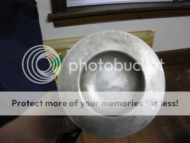

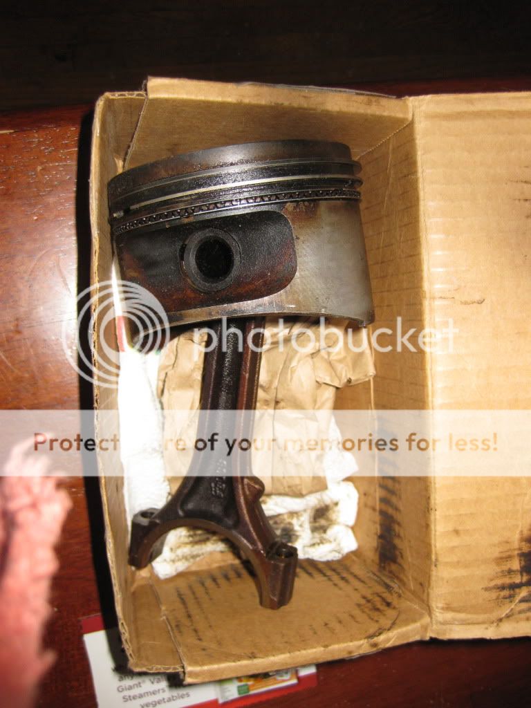

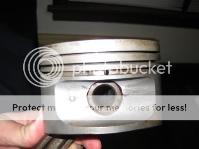

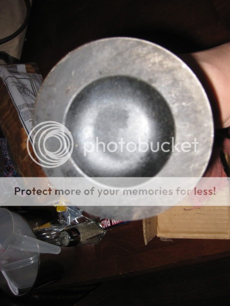

Got the piston for my custom shifter today. :yahoo:
You can see its dirty, and has been used, but the metal looks good, no major carbon deposits, so it shouldn't be hard to clean up.
I'll let it sit in some gas for a day or so and post a new picture after clean up. Then to get it painted up and welded at the angle I want.

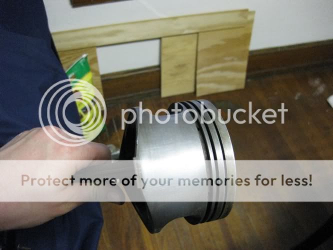

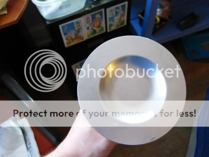

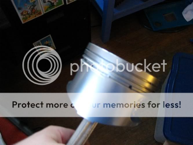

Ok, so after letting it sit in a mix of gas, ATF, and Lucas fuel additive for about a week and then half an hour with a wire scrub brush it looks much better.
Also go it marked out where I want to get it welded in place and get the rod cut off.
Now I just need some paint and an air brush...

the next time you want to clean a part like that, get a old crockpot, fill it with antifreeze, and let it boil over night, be warn though, do this in a well ventilated place, the fumes are deadly, take the parts out while hot, and they will look new, when I was flying r/c planes, this was the best way to clean the little nitro motors before a rebuild, oh and DON'T use the crockpot for food stuff after this.
Robert
this is also a good way to get paint off of items too.

Thats going to be a huge shift knob. How do you plan on welding the aluminum to the wrist pin?
I used a push mower piston on my trans shifter and a chainsaw piston on my tcase. I just tapped the wrist pin hole out to except a set screw. Then I cut the wrist pin in half and cut a V in the end and stuck it into the other side of the piston to center the piston on the shifter shaft.

It is a big shifter, but it cleaned up really nice. I got a guy here at school in the manufacturing or construction (don't remember which) program to weld it up for me in his welding class. The weld doesn't look to pretty, but you won't really be able to see it once it's in.
Those rims do come in a 16x8 5 on 4.5, that was just the wrong link.
I'm not quite sure how I'm gonna attach the piston to the lever.

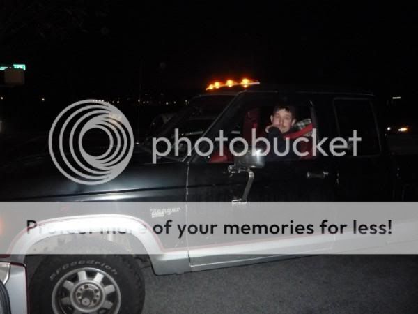

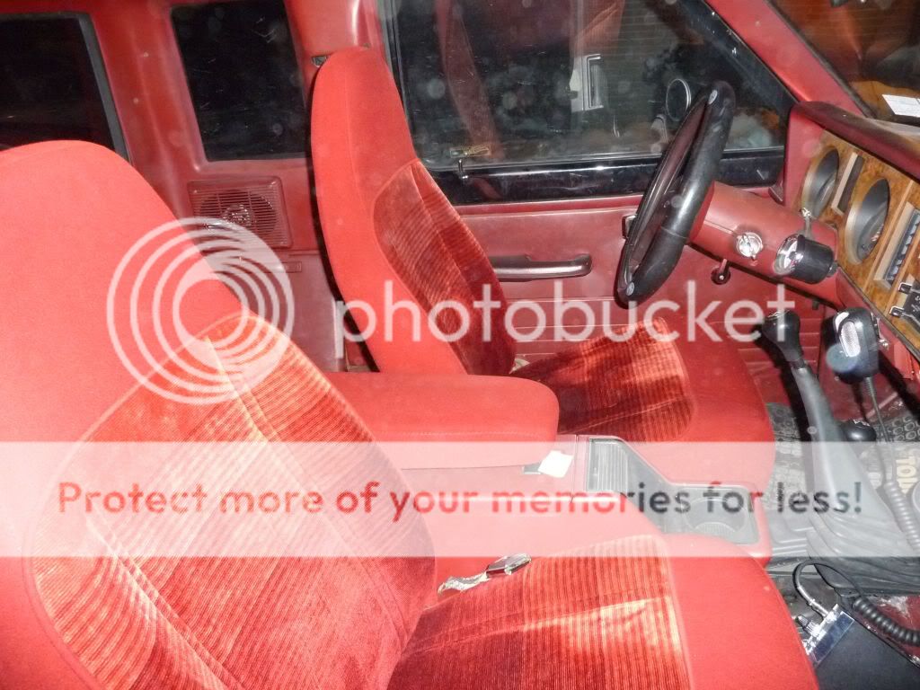

Here is the truck as she sits now:
A nice night pic with the cab lights on:
And here is my oh-so-comfy 91 Ex front seat setup :D
Just gotta get the shifter bezel and center console screwed down.
one of these days she is gonna get all the dents, dings, and rust out and some new paint.

take one of those wire wheel brushes that attaches to a drill and clean up the piston with that. i've been cleaning up the block of my 2.9 with one and it works great. cool idea for a shifter btw
Thanks, I'll give that a try. I'm also gonna get it painted up nice. I have a design for the head that I'll post up in a bit when I get done with my HW and get back from the store.

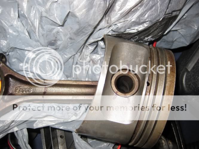

Painted the piston up:
Don't it just look purdy.
