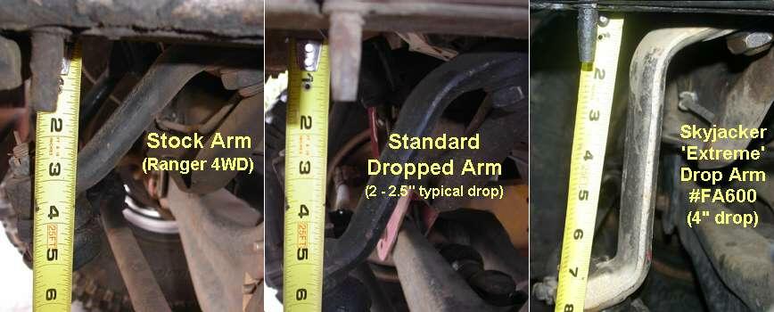

So if you measure your pitman arm like this, is it 7" like the one at right?
And your steering linkage runs straight across (flat, no angle)?
If not, then yeah that's almost certainly the cause when combined with the flexier coils.

_____________Todd said:Ok I just measured my pitman arm as the pic you posted and I am at 5 1/2". I should be around 7" you say? Must have got the wrong arm or something.

_____________________Todd said:5 1/2" from the frame to the end of the pitman arm, 7 1/2" from the frame to the end of the drag link end on the pitman arm. Would 1 1/2" make this much of a differance?

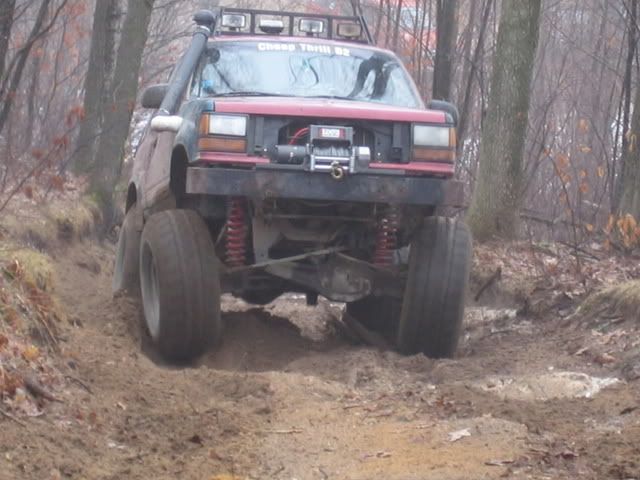

_______________________________cheapthrillB2 said:i had a F250 with TTB that got a 6" lift and he had the exact problem you did, when he backed up the tires pulled towards each other and camber got way out lifting the frt, when he pulled forward it got better but still horrible...........we just did a simple alignment and got his toe/caster/camber in and fixed those problems......
but you def need dual shocks in the frt with the XJ coils, they are way to soft
i just finished installing 9" Rustys XJ coils into this B2,
its got 5.5 superlift TTB brackets, duff ext arms, the 4" drop Pitman and we haven't touched the alignment
when he would climb a small hill the tie rods pulled right in, and when he just drove forward it lifted so high in the frt, in that pic he was idleing forward, when he gased it, it lifted about 6 inches higher in the frt,
he could not drive this thing in my yard it was so scary, i intentioned installed a set of shocks that were to short, so when i installed them sitting level they were maxed out so it could not droop,
here it is after shock install
we are gonna use these shocks until the springs are worn in
but after the shock install he had NO PROBLEMS, drove fine, cornered well, and could climb the hills with no problems
side note* after break in we will install limiting straps for on road or light trail running

____________________cheapthrillB2 said:just slap some thing to limit it level, drive it that way get it tuned in that manner,
were the springs you got used?
i've been told that the XJ springs will sag alot esc if you run a winch and heavy bumper
like in that pic its sitting level with 5.5 brackets and 8-9" coils and it hasn't sag yet so we expect atleast an inch or more of sag

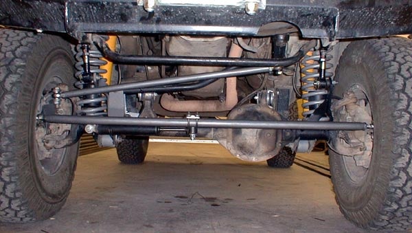

Todd, post up a front pic of your steering with it sitting level.
That's the only way I'll be able to get an idea of what's going on there.
I agree, it sounds like the steering linkage is out of whack and thats what causes the jacking. It sounds like your "drop" pitman arm isnt dropped enough, Id suggest the "extreme" drop arm from skyjacker...
