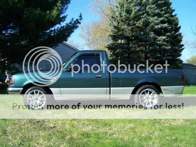

awesome job Reggio. i really like what that truck.
now get that valence and slap it in!
this pic is pure truck sex BTW
reggioisme
June 2011 STOTM Winner
Jan 25, 2009
140
2.3l 4 cylinder
i liked the stock deer hoofs too, but i needed at least 16s to clear the front big brake upgrade
i did rock it for a few days like this until the fr500s came in
