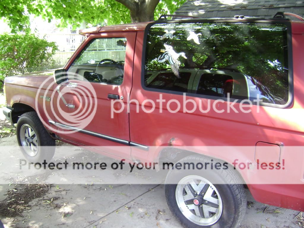

notice the duck stickers LOL

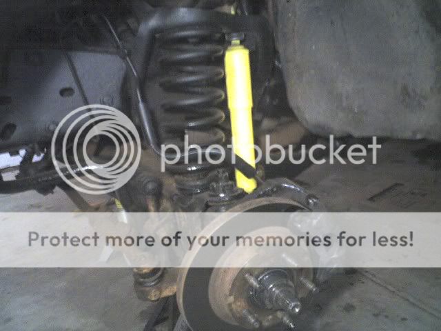

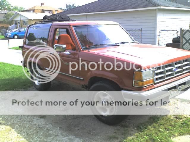

But once I drove this truck I hada instant connection. The motor was tight, the 5 spd was smooth, and it sipped gas - not to mention I found some kick azz lures init! Not long after my nephew turned 16 and his dad got him this awful Nissan Sentra thing that lasted all but a week. So being cool unc I gave him the B2 and so his love affair began (he's yet to get a profile on here, but he will soon). Before I gave it to him though I did the explorer leaf swap, fitted it with some newer-ish explorer rims and did ball joints-tie rods, battery, shocks, etc.. all the stuff that neede to be corrected so 16 year old will see 17...
all cleaned up

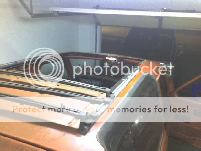

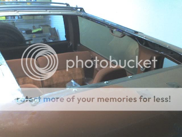

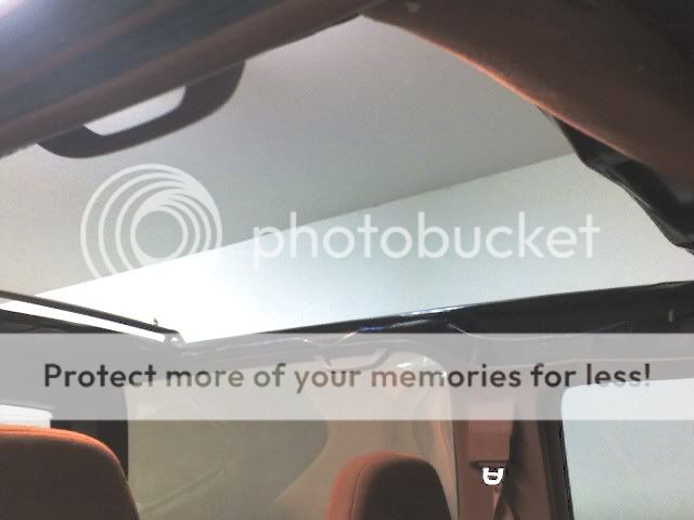

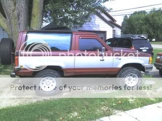

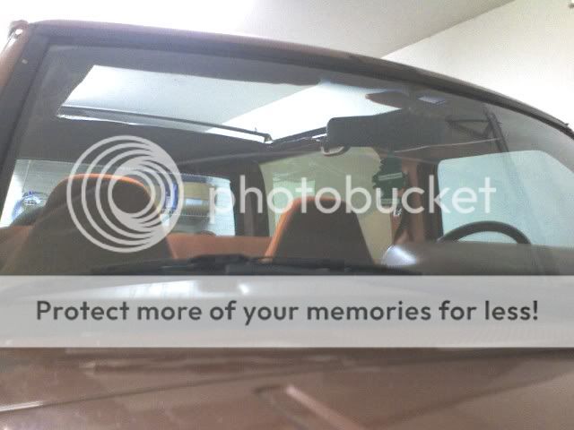

got drunk and removed the roof - beer+sawzall=roofless B2.. Actaully fabbed up a fiberglass top and weather stripping and it seals up nice.

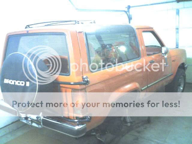

With the exp rims (before the leaf swap) Saggy Saggy Saggy

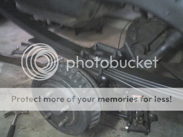

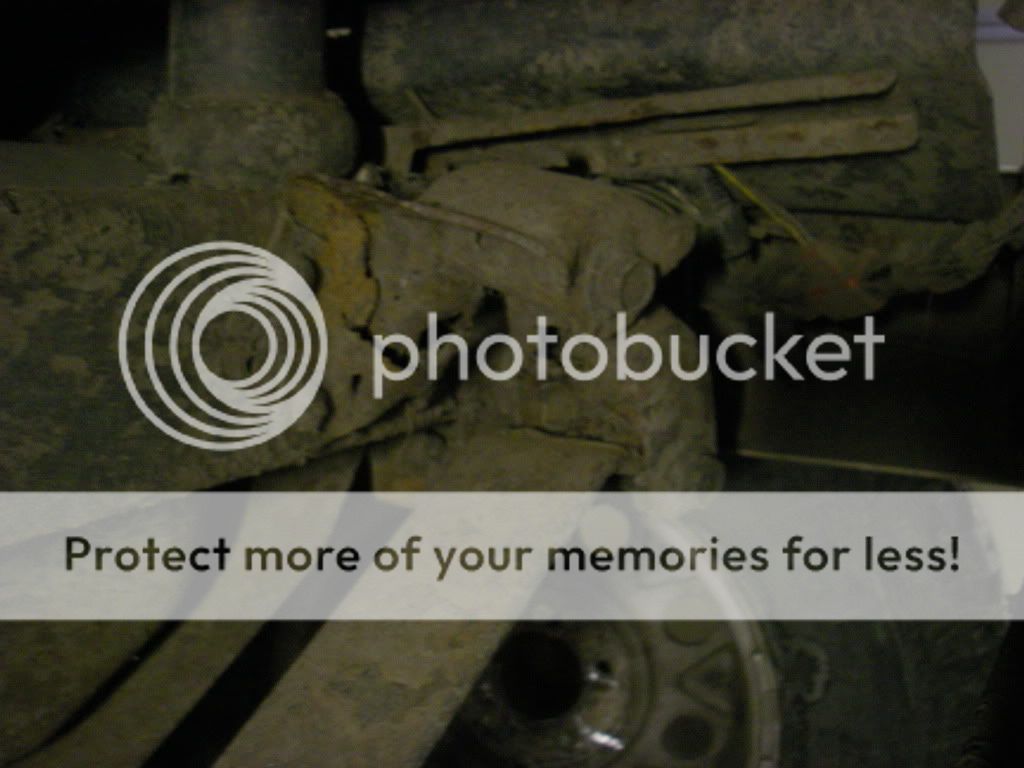

During leaf swap
More Leaf action (sorry crummy phone pics)

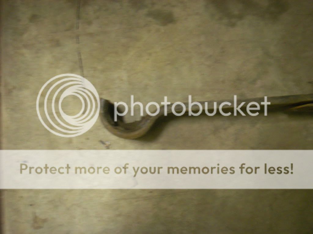

Like just about every B2 this one's leaf cracked on the driverside (mine did the same thing, same spot-not sure if it is a rust belt issue or a B2 issue)

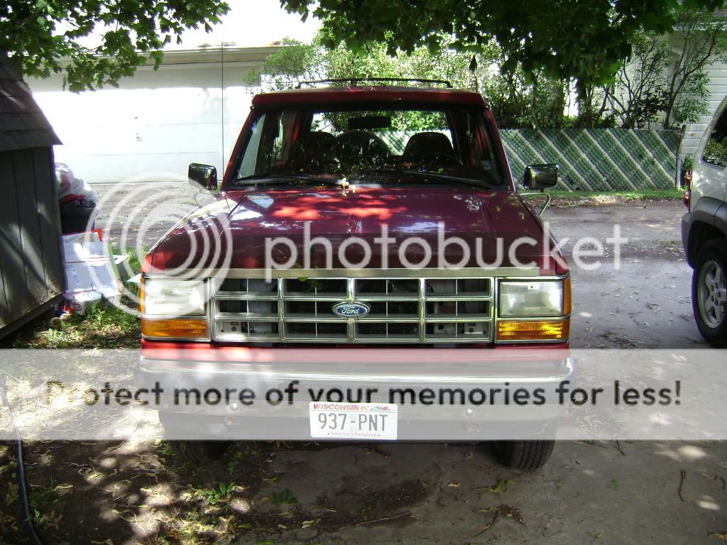

When I gave him the truck I started looking for another B2 and just around the corner from my GFs house I saw one parked with weeds growing up all around it so I stopped, knocked and asked...couldnt hurt. The gut sold it to me for $650 and it dint run. I turned the key and dint hear the Fuel Pump so I checked the cutoff, not that, checked the fuses under hood and under dash, Nope, got under it and jiggled the harness, YUP (that satisfying zzzzzzzzzzzzt ensued :yahoo:)
I changed the oil and drove it up north to the Wiisconsin Dells for an archery meet and some camping, ran like a champ. It really didnt need a whole lot of work until I drove it off road one time. Wow rust sucks.... I really miss living in SC. Rust is not an option (not like here anyways) So here's some pics of the leaf swap that turned into 6 mos in the garage...

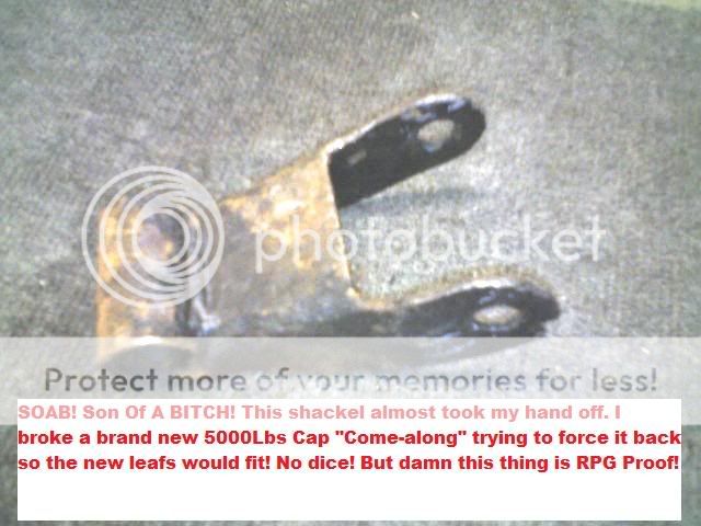

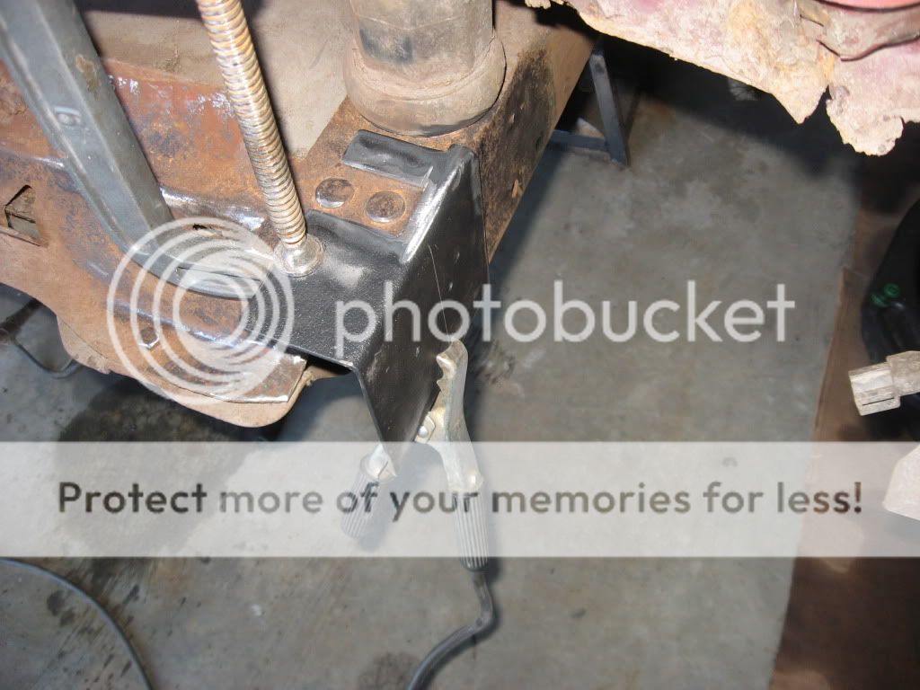

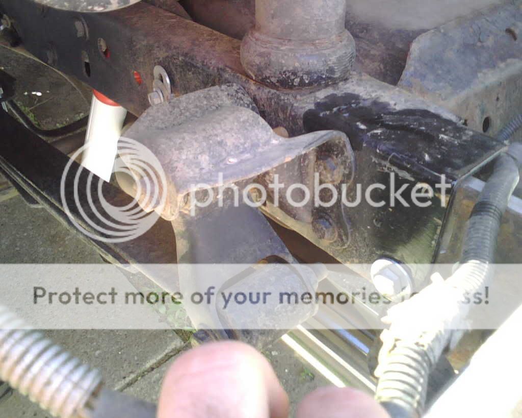

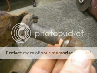

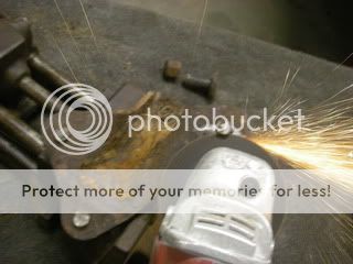

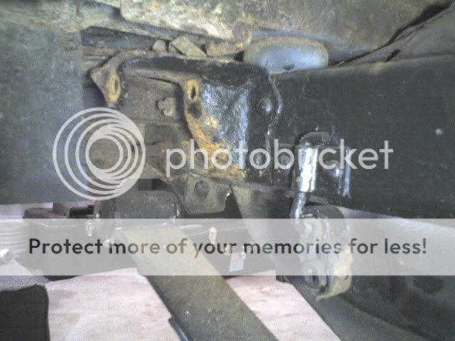

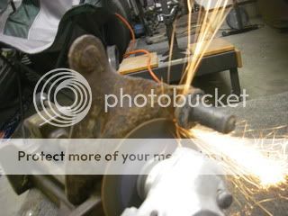

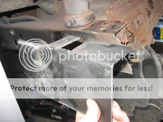

I hada fab up some pieces to go on the frame as the shakle hanger kit came from a ranger and the bolt holes are different...Also snapped a shock stud and had to grind out the old one fun fun fun
remounted the new shock hanger with grade 8s from Menards and installed new shocks

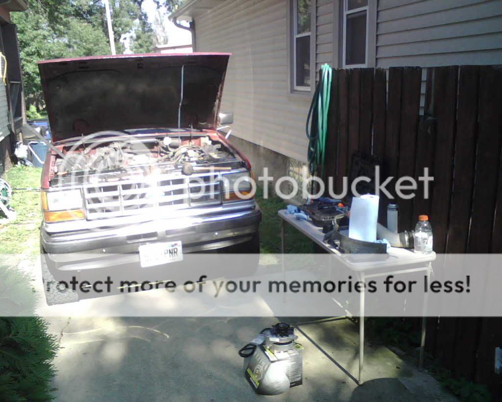

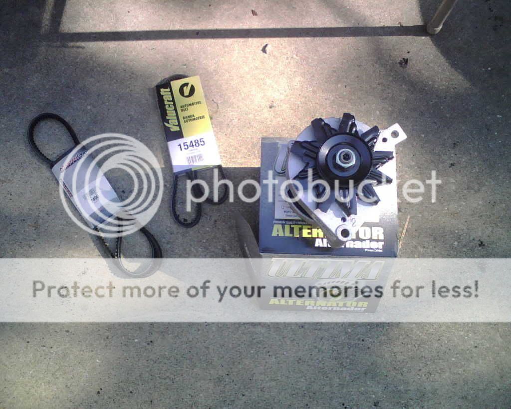

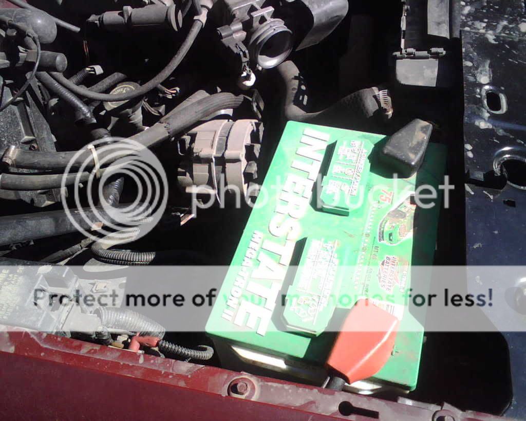

I dint get a chance to take pics right after the new leafs were installed but I took some today when I put the new alt, batt n cables in..
Installing new alternator battery n cables today...

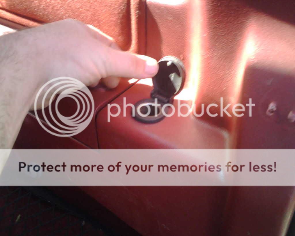

I also Installed a rear aux power point - got it from a Windstar, also plan to put and additional one up frony under the wiper switch. It's gota nice little spring loaded top on it

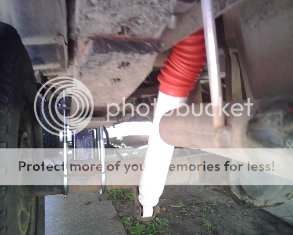

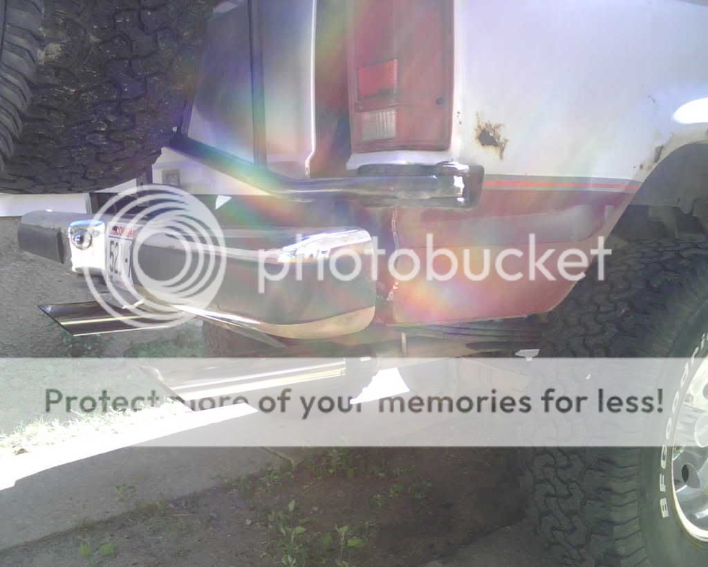

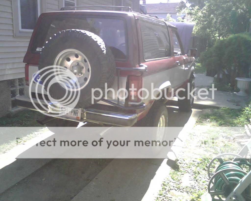

Last week I did the three in blocks on the rear end so I needed shocks that would fit better. I mdidnt wanna do blocks but I had duals put on it and when I took it on the trails every bump I hit the rear ujoint was hittin the one pipe. I didn't have the heart to go back and tell them they need to gut it so I jacked it. I Plan to get rid of the blocks and just do a big ole helper sping pack...
heres some pics of the block, shocks and exhaust..

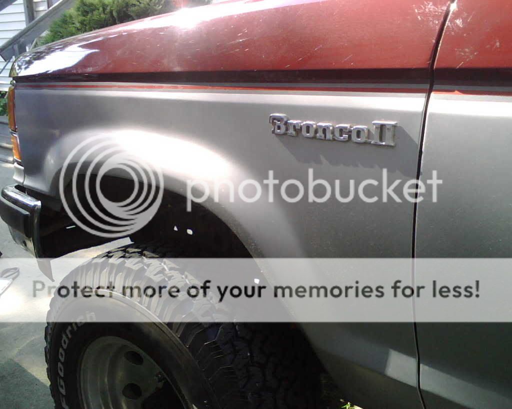

I also got rid of the pepsi-clear-esq broncoII logo and did the older style one.

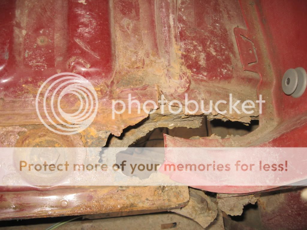

It has gotten so bad after my last trip on the trails in the Dells that the rear of the truck jumps if I ti a bump - like the outside of the truck jumps but the seats in back are good. Scary.

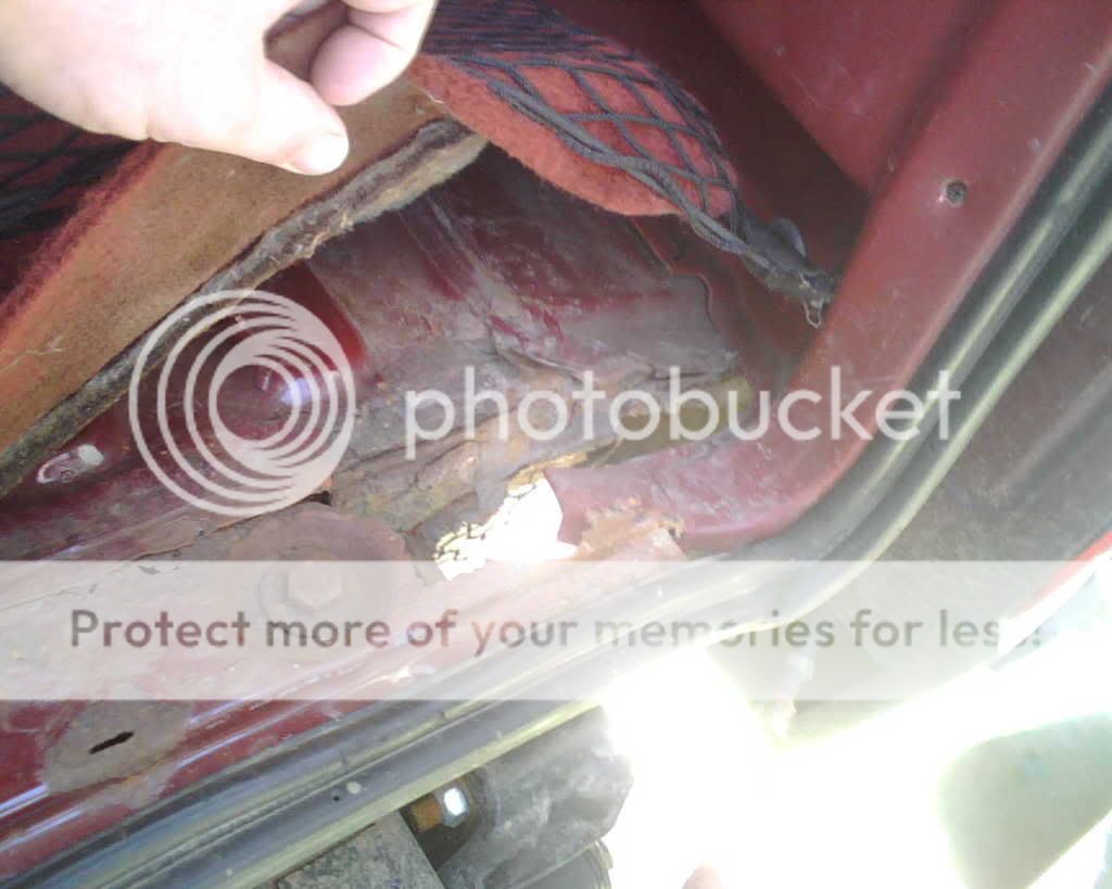

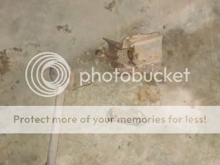

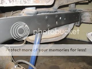

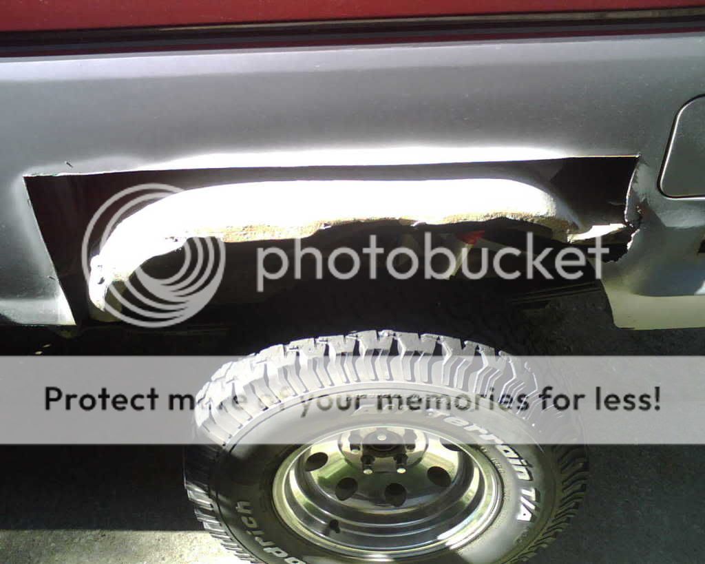

The QPs are rotted all the way through both sides. I picked up some extruded c channel steel and some angle iron and found a shop that would weld it up right.
I need to find some good QPs --- LMC discontinued them and I really don't wanna pay $169 for the whole QP..
more pics to come! Anyone with a set of QP partials please pm me!

Need MOAR PICS. I wanna see this fiberglass roof that you built.

Haha right now the nephew is MIA. After school let out he hit the road. All I know is my sister keeps callin me an harping "That G*damn top you made is layin in the back yard and the inside is gonna get moldy, nag, nag, nag" I have some pics for the first top we tried (an failed miserably) we did a vinyl top with snaps - but then it rained and became a giant pool LOL. The new top I made from a ranger tah-no teannue \\cant spell it// that bolts on w/ 6 bolts n wing nuts. I wanted him to come over during the 4th weekend to do hood pins instead of bolts but he's MIA.
It is such a blast to drive with no roof, and the cool side windows and most of the integrity is still there too. When I finally track him down I'll get pics of the top on it.

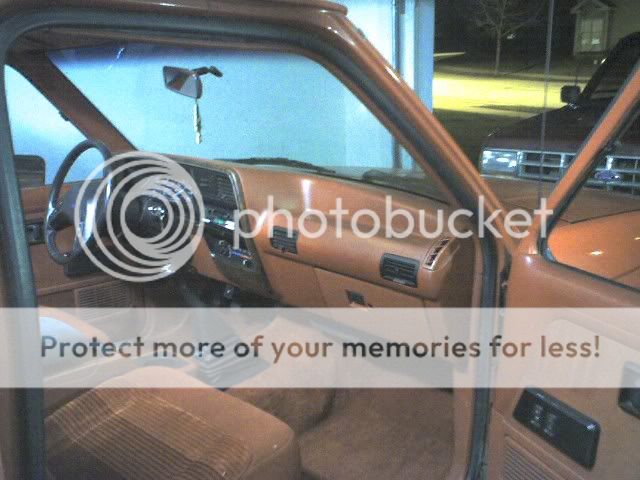

I just noticed that your nephew's interior is brown?? I thought it was only tan, gray, black, blue, or red?
I think that's a red interior in crappy lighting.

crappy lighting along with crapy cell phone make for crapy pics. It is red, i musta shampood it 12 times - it used to be brown lol.
