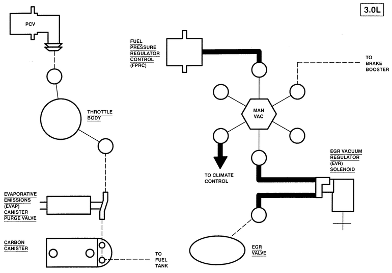

I was having the notorious "everything blows out the defroster" problem, so I pulled a few vacuum lines and bypassed a thing or two to find the problem. I got the vents working the way they should but now I'm not getting anything but hot air. In order for me to further diagnos my problem I need to know what belongs where and I am having trouble finding the vacuum diagram I need. This is the one from the tech library, I need to know what it looks like after it reaches the point labeled "to climate control". Any help would be greatly appreciated since it is started to get hot around here.

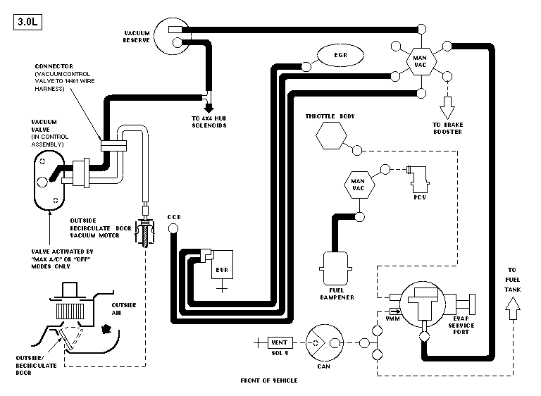

Does this help you?

Sasquatch, that looks very similar to what I'm dealing with, I'll print this out and take it under the hood with me tomorrow and see what I can figure out. I thought I had just taken out the lines for the PVH's but it seems there is a little more to it. If anyone else has any other diagrams please post them, the more pictures I look at the better.

That's straight out of the Ford EVTM (electrical/vacuum trouble shooting manual)
